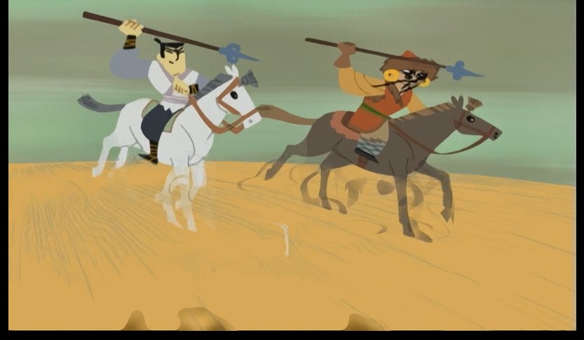

Despite the hours i just spent on experimenting with the plugins there are some artifacts remains i'd like to get rid of. For example SVP cannot seem to handle VFR (variable frame rate) inputs without losing the sync with the audio signal, and when it comes to motion estimation between frames it sometimes cannot handle them very well. Attached an image. This happens when fast motions come into play (notice the lines on the ground are also wavy), while the backgrounds are just interpolated smoothly.

To reduce artifacts you need to remove black borders from your video. You can do it with SVP autocrop option or manually.

Managed to fix a couple of artifacts just by tweaking the svp settings. I mosly just reduced the distance and range parameters that removed most of the artifacts.
The example image was a bit misleading since there are no borders around the content.
