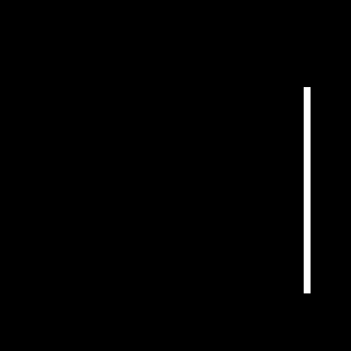

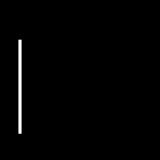

To give you an idea of the differences, I have created these simple high-contrast 2D images (to reduce the attachment size and better illustrate an exaggerated example of the differences). Imagine this simple translational movement as representing a difficult motion to interpolate (big displacement, occluded pixels, non-uniform lighting, etc), from image a to image b:
                                                      Image a:
a
                                                      Image b:
b
Ps. Continue on next post because of 3-attachment limit (need 4 images to display the difference)
a.png, 2.28 kb, 512 x 512
b.png, 2.28 kb, 512 x 512

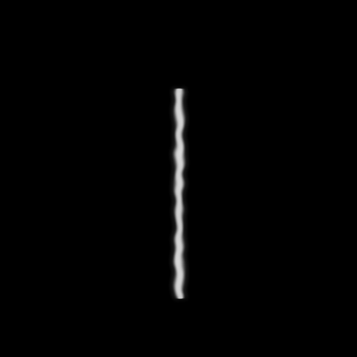

Then these images approximately show the different 'style' of interpolated (simple frame doubling) frames produced by the two SVPs:
                                                        SVP 3.1.7
SVP317
                                                          SVP 4
SVP4
Basically, SVP 4 produces 'jumpy' images (like watching a 24fps video on a 48hz el-cheapo lcd with very slow pixel response times of >20ms), while SVP 3.1.7 can be configured to produce more 'wavy' artifacts, but actually moves the objects in the frame to produce a new frame with the objects in-between their respective locations in the previous and next frames (which I find to be the whole point of motion interpolation, but some {most?} people seem to prefer the SVP 4 way).
This does, however, only affect difficult motion areas. In places without much temporal aliasing to begin with, both SVPs perform very well and generate a proper interpolated image.
