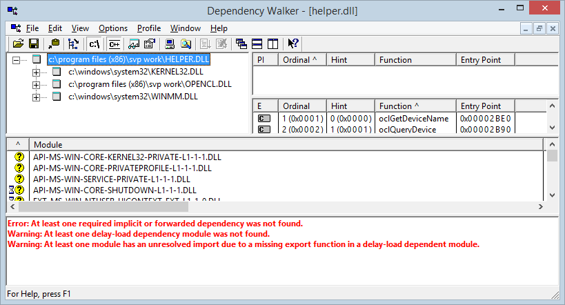

Do you see 'helper.dll' file in SVP installation directory?
Try to open it with that tool. Will you see any errors?
It should look like this ---> see attached image
helper.png, 31.56 kb, 819 x 442

I don't know if something's wrong on my side but I can't see the attached image.
But when I open it with that tool, I got
Warning: At least one delay-load dependency module was not found.
Warning: At least one module has an unresolved import due to a missing export function in a delay-load dependent module.
Not sure if it's the right one though.

Nvm, I managed to look at the image you've attached, what I got on 'Dependency Walker' is
'Error Opening file. The system cannot find the file specified (2)'
This error was shown on .DLL with '?' icon
