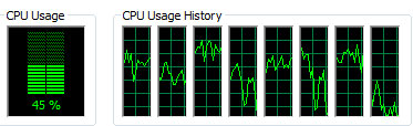

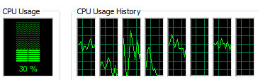

Numbers don't lie. Here are CPU utilization screenshots with with GPU enabled and disabled.
Intel quad-core i7 with Radeon HD 7670M
CPU.jpg, 19.73 kb, 373 x 114
GPU.jpg, 20.49 kb, 364 x 113
