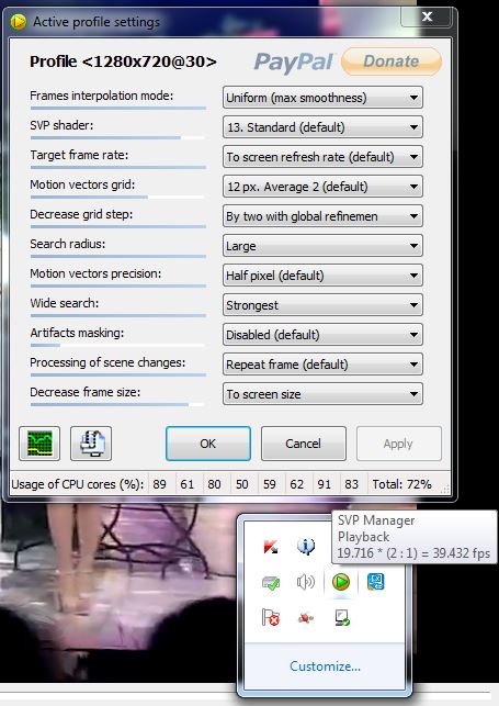

SVP made a weird frame ratio decision! 19.716 with a ratio of 2:1 to play at 39.432 on 60hz display? What's that?

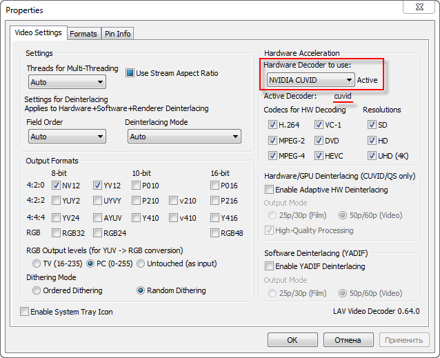

What format are you using in SVPtube? I use 720p MP4.
What hardware decoder are you using in MPC-HC? I use CUVID from LAV Filter decoder.

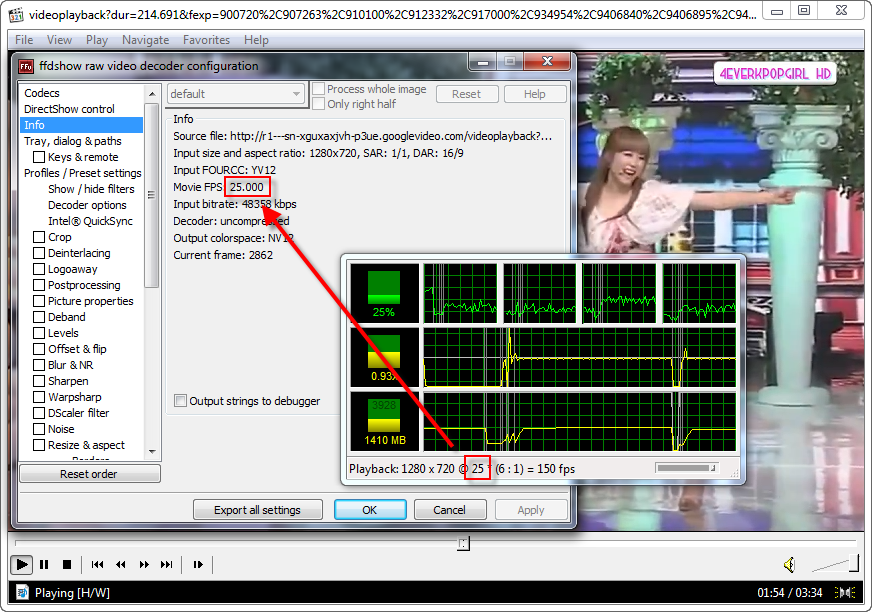

What resolution and format are you downloading? I have been watching 720p MP4. It has 25 fps.
In any case, SVP gets framerate from ffdShow. And it is happened when ffdShow shows wrong unstable framerate. I saw it very rarely. Maybe it is just your case?
Open video, start playback, select by menu Paly - Filters - ffdShow - go to Info tab.
