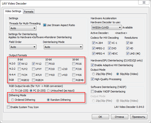

Do you use OpenCL acceleration in SVP (SVP-Manager tray icon - GPU-acceleration)? It works more precize with colors and must help to avoid banding.
If your video 10bit depth then I recomend to use dithering in LAV Filters to convert video to 8bit with high quality and without visible banding artifacts.
http://www.svp-team.com/forum/misc.php?item=3385
I use these settings to watch 10bit movies with SVP.

But anyway, I have all my settings like you instructed (GPU-acceleration / OpenCL checked, random dithering, output formats only NV12 and YV12) and the banding is still there as soon as SVP activates.
