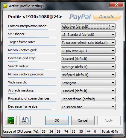

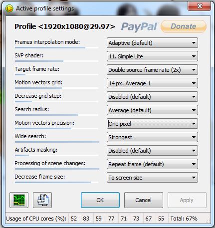

Re: Why is this video lagging
Before creating the new profile, it was using the 24fps profile. I lowered the settings in the 29.97 profile. See attached pictures.
24fps.jpg, 52.1 kb, 421 x 463
30fps.jpg, 50.68 kb, 431 x 457
