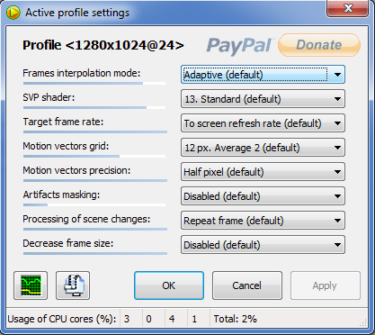

Greetings, I'm a kinda new user of SVP, I've tried to read a lot of guides on how to set it up properly, but I'm still in a bit of confusion and not sure if I did everything correctly.
I'm using:
Windows 7 x64;
LCD 1280x1024 monitor (75hz);
SVP configuration (everything is x32):
SVP 3.1.6;
SVPtube 1.2.2;
madVR 0.87.10;
MPC-HC 1.7.7.128;
avisynth 2.6.0.4;
XySubFilter;
ReClock 1.8.8.4;
Internal LAV Audio/Video/SplitterSource 0.63.0;
ffdshow (rev4532) raw video filter;
I was using these guides:
http://www.svp-team.com/wiki/SVP:MPC-HC
http://www.svp-team.com/wiki/SVP:User_manual
http://husmensblog.blogspot.ru/2013/10/ … guide.html
http://myanimelist.net/forum/?topicid=516729
Can someone, please, explain what can be added/removed/changed to achieve the proper result?
Is it normal to use ffdshow, internal LAV filters and madvr+reclock with SVP at the same time? If yes, should there be applied some kind of changes in settings of those filters?
Huge thanks for creating such a great tool, I hope I've provided all of the necessary information and thank you in advance for the replies.
Config.png, 35.39 kb, 417 x 372
Re: Need help configuring SVP at 1280x1024.
VinylNix
Yes. To use madVR you need powerfull graphic adapter. To use SVP you need CPU core2duo at least.
I use all these components. I have GTX 660 Ti + Core i5-3570K.
avisynth 2.6.0.4;
I recommend you to use 2.5.8 SVP edition. It will work faster and needs less memory. If you don't need 2.6.0.4 for another tasks, of corse.
XySubFilter;
Why you need it? I can see any subtitles with MPC-HC (internal LAV) + madVR.
About SVP profiles. It is not user's or monitor's profiles. So the profile 1280x1024 will not work correctly hmm
See details in topic I can't switch profile?

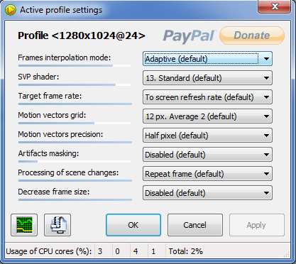

Also, should the configuration of filters (in case of SVP) look like this in MPC-HC?
http://www.svp-team.com/forum/misc.php?item=3291
One last question, If I will post my settings (in pictures) of those filters, can you check if they are generally correct?
Filters.png, 4.23 kb, 243 x 168
Yes. Your filters list is correct.
If SVP works then settings of these filters are correct. wink
