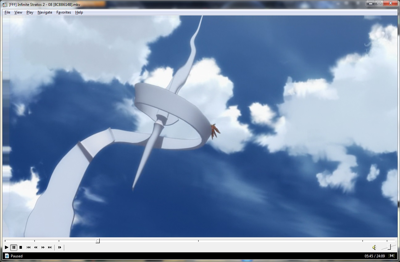

13 (edited by mashingan 07-10-2014 00:08:03)
Re: 64/128px Block size?
Hi, the guide actually is already old big_smile
The best setting is your default setting. Then you can change several setting to fine tuning it.
Of course you wouldn't want change the setting too far away from the default big_smile
I've compared it, the guide setting and my default setting. The default setting definitely better.
You could select your favorite "benchmark" video big_smile and see the differences when you change the setting.
Oh, this is the screenshot from my "benchmark" video
http://www.svp-team.com/forum/misc.php?item=3257
But this is kinda extreme and very rare case, additionally, the scene movement is very fast.
(That's why I made it my "benchmark" video  lol )
Edit:
Procrastinating wrote:
http://a.pomf.se/aojlih.webm
I've seen your webm video, the image really smooth and sharp in my player.
I don't watch the Kill la Kill, but I didn't notice any distorted image. Your webm file is even better than my "benchmark" video. big_smile
