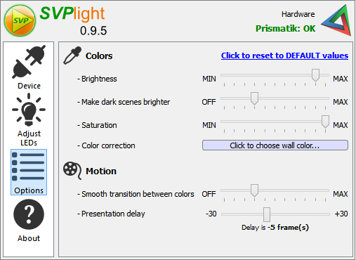

Version 0.9.5
+ added new color and motion tuning options
= fixed importing some Prismatik profiles
= improved UI
= work period expanded to 1 May 2014
http://www.svp-team.com/forum/misc.php?item=3115&amp;download=0
svplight-095.png, 27.74 kb, 507 x 370

Version 0.9.6
+ added ability to adjust some options on-the-fly
= fixed color correction on dark scenes
+ order of colors can be changed now
= work period expanded to 1 July 2014
The "Options" tab is available now while playing video with lighting turned on.
