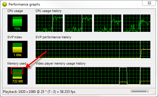

It is strange. SVP must allow much bigger memory use by player if you have 4+ GB RAM installed.
See Performance graphs window and amount of available memory for player.
http://www.svp-team.com/forum/misc.php?item=2981
Please show your AVS-script: SVP tray menu - Information - Last used AVS Script
performance_graphs_3965MB_free.png, 11.72 kb, 539 x 332
