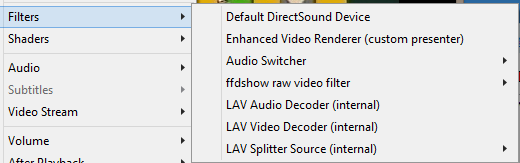

I've all of "source" and "transform" filters checked on the "Internal filters" tab and only one "ffdshow raw" checked in "External filters" and it's all working as expected / as usual.
Check properties of "ffdshow raw" - it should be set to "Raw video" = "all supported" on the "Codecs" page.

40 (edited by sausje 03-12-2013 19:54:40)
Re: Youtube app won't allow 1080.
I have exactly those options, only for me in the menu you are showing the "ffdshow raw video filter" still doesn't bother to show up..
So after some trying, i thought that "what if i just removed MPC their added LAV filter files?", and so i did (removed the folder named "LAVfilters" from the directory that has the .exe).
With that it was forced to use the external ones and the smoothing did work.
But now it's back to only having 10 sec video's on 1080p..
So after that i just renamed the LAVVideo.ax to LAVVideo.ax.bak (from the folder with internal LAV filter), and now it uses the internal one for sound and external for video processing, that seems to work for now.
It's not perfect, but at least it's working now.
