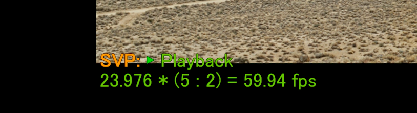

I just installed the entire SVP package, containing a fresh installation of MPC-HC, Reclock, AvSynth and FFDshow on my Windows 7 machine but everytime I start MPC-HC and run a movie I get the following errors....
http://img856.imageshack.us/img856/5981/6lkb.jpg
Here is a copy and paste of my log file:

2. Do you see two SVP-messages in your player as at your picture every time?
In normal it must be only one message at the bottom of the frame.
http://www.svp-team.com/forum/misc.php?item=2734
SVP_OSD.PNG, 239.05 kb, 814 x 221

Hello mag79 and thank you for your reply,
First of all, to answer your question, no...I do not see any green SVP messages on my screen in MPC-HC at all.
I have disabled gpu acceleration and now I no longer get the script error, but now MPC-HC just hangs and either the picture doesn't move, or the whole player crashes. SVP is telling me my "video player has ran out of memory" which doesn't make any sense to me since I have 6gb of DDR 3 system ram. I have MADVR, ReClock, LAV, and FFDshow all enabled and no video playback problems without SVP, but as soon as SVP is activated MPC-HC crashes or just hangs.  The main pop-up error I get every time I run SVP is

12:27:35.943; ===== Playback
23.976 * (5 : 2) = 59.94 fps
12:27:35.943; SetPriorityPlayer: 2. Duration: 7920 ms

12:32:15.052; ===== Playback
12:32:15.052; SetPriorityPlayer: 0

12:34:02.207; ===== Playback
12:34:02.207; SetPriorityPlayer: 0. Duration: 513 ms

12:34:17.481; ===== Playback
12:34:17.481; SetPriorityPlayer: 0. Duration: 15455 ms

It appears I may have figured out how to get a fairly steady fps....seems the upscaling methods in MadVR have a serious effect on SVP and is a resource hog. I was using jinc 3 taps and then I decided to switch everything to nearest neighbor, and now I'm getting pretty much 60fps in fullscreen. Problem is, I don't want to be restricted to nearest neighbor. I want to be able to use jinc 3 taps *AND* achieve a steady 60fps in fullscreen Any other suggestions?
Also, can someone *please* suggest a framerate display counter other than fraps? I can't tell what frames I'm getting unless I use fraps or an alternative.
*edit*: Hmm, video is now choppy again even with nearest neighbor on madvr upscale and no fraps. WTF sad
