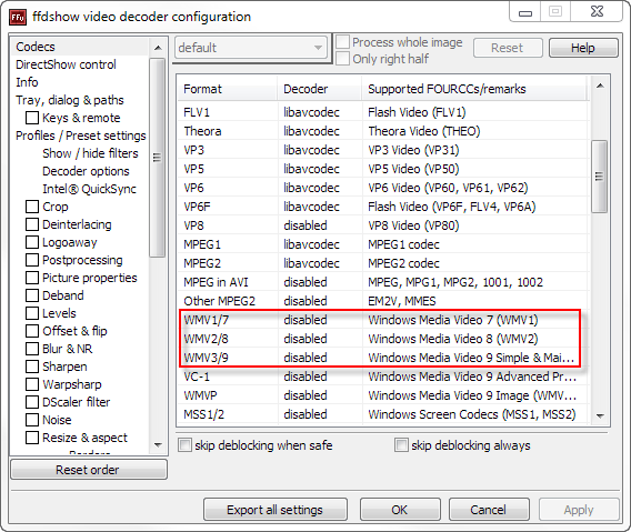

why despite the fact that the video decoder settings I have checked everywhere ffdshow WMV files are decoded by LAV Video decoder ???

ffdShow has its own settings for each format.
http://www.svp-team.com/forum/misc.php?item=2426
If you want to use then enable them.

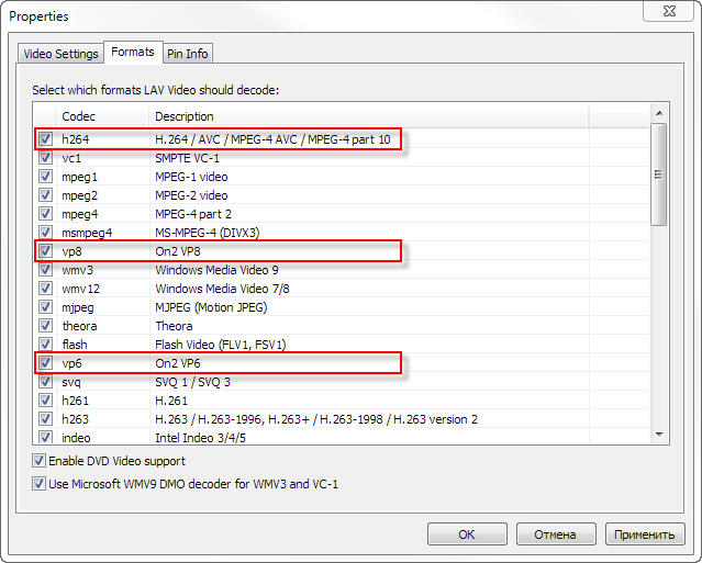

FLV1 is very old format (and old container). All todays online video have new FLV4 container. It can contain VP6, VP8, AVC video streams formats. Try to enable this formats or use another decoder.
I use MPC-HC player, MPC FLV Source splitter and LAV Video decoder. It works.
http://www.svp-team.com/forum/misc.php?item=2428

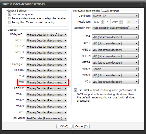

Why PotPlayer still load to decoder VP8 file Video Codec/Transform (Dekoder FFmpeg (vp8) ) ???

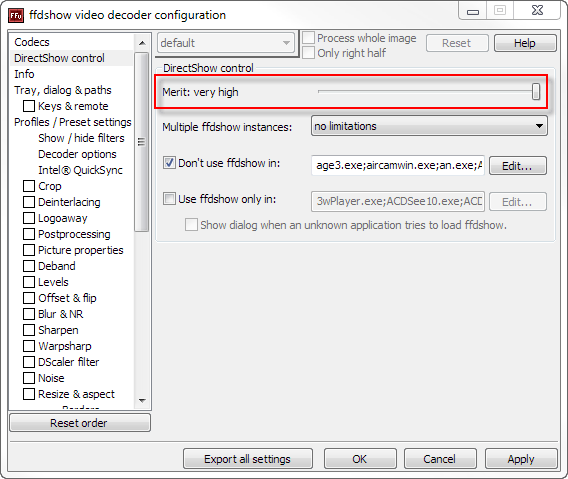

Try this:
http://www.svp-team.com/forum/misc.php?item=2429
But I think it can not help. PotPlayer do not provide ability to use external decoder for VP8.
http://www.svp-team.com/forum/misc.php?item=2430
Why you so much want to enable ffdShow decoder for VP8? LAV is better. Internal PotPlayer's decoder is the same (ffmpeg).

As I can see, PotPlayer has always enabled built-in decoder for VP8. I can't disable it. I use another player: MPC-HC. I like it. There I can use LAV decoder for VP8.
BTW I do not see anything wrong with that PotPlayer uses built-in decoder.
