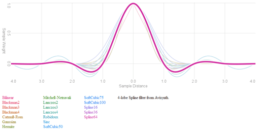

Re: Best configuration SVP for my system
Michael
I googled for you.
1. LanczosResize taps or lobes.
2. Lanczos vs Bicubic comparison: Lobes vs. Taps. The short version.
3. ResampleHQ kernel visualizations. Interactive visualization of various resampling kernels.
http://www.svp-team.com/forum/misc.php?item=2419
ResamplingKernels.png, 14.3 kb, 510 x 258

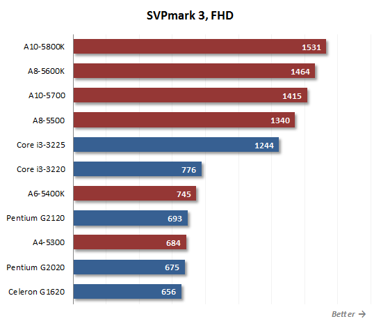

Andrew LB
I have sad news for you: SVP uses OpenCL not QuickSync.
HD3000 not supports OpenCL. HD2500/HD4000 support OpenCL. OpenCL is based on Pixel Shaders units which is not so fast as Quicksync transcoding unit.
http://www.svp-team.com/forum/misc.php?item=2436
SVPmark_results.png, 11.19 kb, 548 x 471
