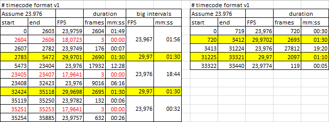

I see common things for both vfr-files. They have two 29.97 fps parts: near beginning and before ending.
http://www.svp-team.com/forum/misc.php?item=2413
What is it? Computer animation or running string-subtitles?
I ask because I need to know all frames in these parts has movements at framerate 29.97 or only region in frame (subtitle for example).
VFR_mkv_features.png, 8.16 kb, 641 x 239
