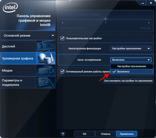

To avoid tearing of vertical lines you need to enable Vertical Synchronization in your Intel HD Graphics driver.
Like this (Russian GUI):
http://www.svp-team.com/forum/misc.php?item=2337
VerticalSync.png, 57.98 kb, 651 x 573

I activated, but the problem still exists. Indeed, it seems worse.

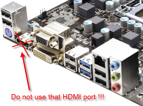

HDMI cable from TV inserted into NVIDIA card? Are you sure?
http://www.svp-team.com/forum/misc.php?item=2355
HDMI_on_MB.jpg, 50.3 kb, 469 x 348
Re: Best configuration SVP for my system
I checked again. the HDMI cable is attached to the nVidia video card.
