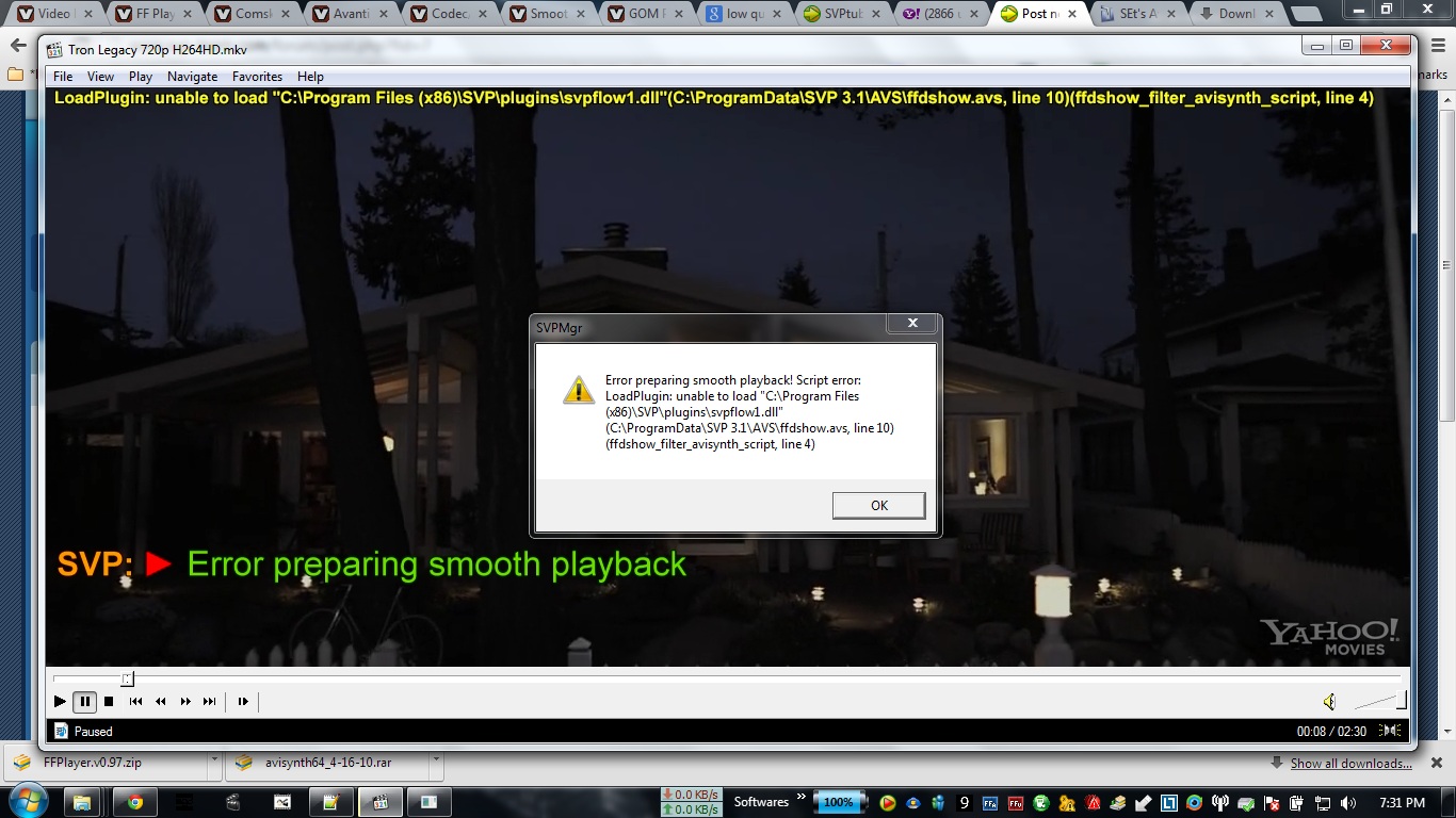

I have installed SVP 3.1.3 Lite and it works perfectly with ffdshow x86,Avisynth x86 ,MPC-HC x86 smile  lol .
but when i tired it with MPC-HC x64 an error appears  sad  and i have attched a image of it.
i have manually installed  Avisynth 2.5.8 x64 because SVP needs it.
but it seems SVP is not supported using x64 .
the problem is, i need to Exit SVP or Temporally disable while using MPC-HC x64 . is there any solution for that ?
because avisynth x64 is deep alpha, and x64 plugins is deeper beta
