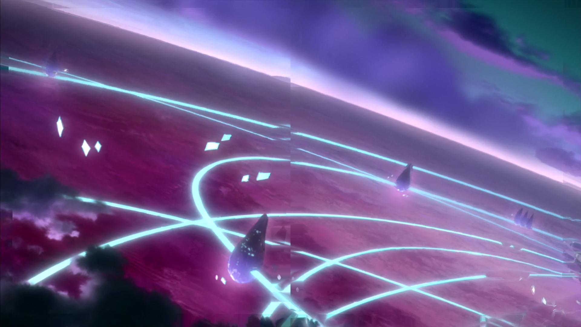

After I upgraded to 3.1.3 my video now have a vertical tearing on the middle of the screen.  I downgraded back to 3.1.2 and the problem was gone so it must be something from 3.1.3.
My Specs are
i7 2600k @ 4.8ghz
GTX 680 sli

vertical tearing
Maybe horizontal tearing? If yes then enable VSync in your video-drivers.
Oh. I see the picture. It is vertical tearing. You are right.
Try to select Plain 2D in SVP tray menu option Stereo mode (3D).

Re: Tearing
Yep it helped.  There is no more tearing on the middle of the screen.
