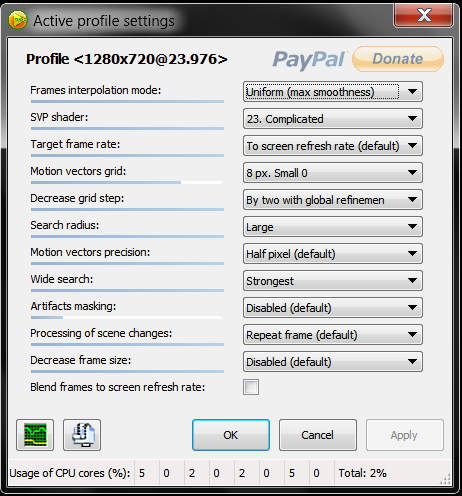

Here is the sample:
http://www.mediafire.com/?dygotr4d00nd71r
See attached file for my settings.
Immagine.png, 54.69 kb, 462 x 496

It is serious bug. And it will be not simple to fix it. And not fast.
Now you can change Motion vector grid to 24 px. Large 2.
It is not ideal solution. But you will be able to watch video without annoying wave artifacts.
It is temporal solution. Until the real fix will be implemented.

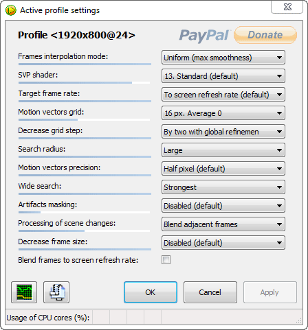

BTW, try this settings:
http://www.svp-team.com/forum/misc.php?item=2159
ProfileSettings_forSports.png, 16.58 kb, 448 x 481
