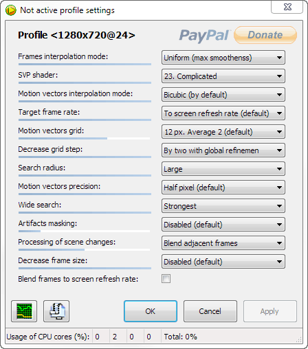

Hi guys,
While playing 23.976 movies I just want to know which options to select to achieve maximum smothness even if this means dealing with artifacts. My TV supports maximum 60Hz so I will interpolate 23 to 60, that's for sure big_smile (just out of curiosity I read somewhere that human eye cannot tell the difference of videos above 60fps, but I guess some of you interpolate to 100 or 120Hz screens, do you see any difference by doing that?)
Here Below the settings:
Interpolation mode
Uniform
SVP Shader
which one gives the max smothness?
Motion Vectors grid
Search radius
Motion vector precision
Wide search
Processing of scene changes
In order to obtain max smothness having to deal with the system power is preferable to use small motion vector grid values and set the motion vector precision at one pixel or is it better to use higher motion vector grid values and leave the motion vector precision at half pixel?
While playing 1080i50/60, if in Lav Video Settings is checked "video mode" you have a 1080p50/60 deinterlaced picture, SVP shows 1:1 convertion and does nothing even if option "processing of scene changes" is set to blend adjacent frames right?
In you opinion for 1080i50/60 videos is it right to deinterlace them in "video mode" wihout SVP? From what I know in a 1080i video each frame has half the inormations but each frame is also a different moment in time, so even if frames are in reality 1080 lines half 2 they indeed are 50 and 60 fps so there is no need for SVP, especially if you have a card that can handle adaptive (vector based) deinterlacing in order to rebuild the missing informations via vectors, just like SVP does, am I right?
Thanks smile

Re: Maximum Smothness No Matter What
AndreaMG
Maximum Smothness
OK. What you mean under these two words?
4. smoothness
(noun)
the quality of having a level and even surface
"the water was a glassy smoothness"; "the weather system of the Pacific is determined by the uninterrupted smoothness of the ocean"
5. smoothness
(noun)
the quality of being free from errors or interruptions
"the five-speed manual gearbox is smoothness personified"
In case with SVP defenitions #4 and #5 are opposite. We cannot achieve even surface of motions and free from errors (artifacts).
If you need uniform and even motion then it is definition #4. Then you need these settings:
http://www.svp-team.com/forum/misc.php?item=2026
Max_smoothness_settings.png, 15.61 kb, 448 x 508
Maximum Smothness
    4. smoothness (noun)
    5. smoothness (noun)
Thanks Mag, I'll look in the russian forum with google traslator smile
For smoothness I mean the opposit of jerky, I want to obtain via SVP something that resembles an actual 60fps footage, that's my goal, even at the expense of artifacts (blocks, or waves when I use complicated) big_smile
