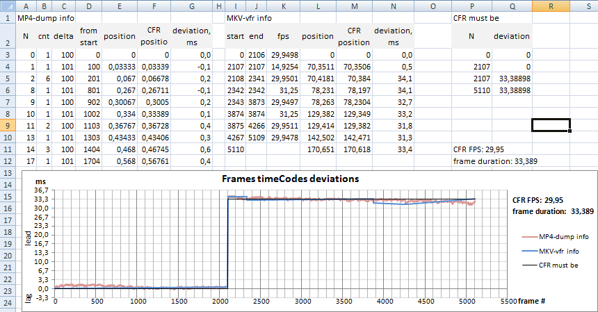

About CFR calculation. This is graphical result (I computed it in MS Excel): deviations of frames timeCodes. Data of clip2 used.
http://www.svp-team.com/forum/misc.php?item=1977
Graphic shows how early (lead) or later (lag) each frame will be dispayed if play frames at constant frame rate 29.95 fps.
As you can see maximum deviation is about 2 ms. MKV and MP4 data is close to each other. And we have one drop at the middle of the video. We must to insert one duplicate of frame to fix frames lead after drop.
QTInput(vfrFPS=29.95) and DirectShowSource(fps=29.95, convertfps=true) will do it automatically. All frames will opened. Without losses. All frames are at its own places.
deviations_clip2.png, 19.32 kb, 860 x 449
