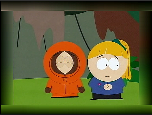

what is the best way to deal with the missing corners problem
well, not "missing"...
http://www.svp-team.com/forum/misc.php?item=1957&download=1
double-light.png, 334.41 kb, 512 x 389

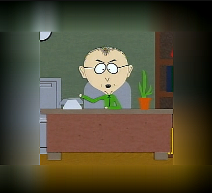

Re: Rift HMD, black borders lighting and stuff
Another one, different settings
http://www.svp-team.com/forum/misc.php?item=1958&download=1
double-light-2.png, 192.67 kb, 416 x 379

Cool, that looks ok!  I was worried we might have 4 black squares!  If we can soften the frame edges a bit that should be fine, maybe we can mirror the bars effect back over the video frame itself, but the mirrored side would need more fading (get much lighter towards the center) but this still would not work in the corners right?  Can you post the usage syntax for the above?  Thanks again for testing it.
smile

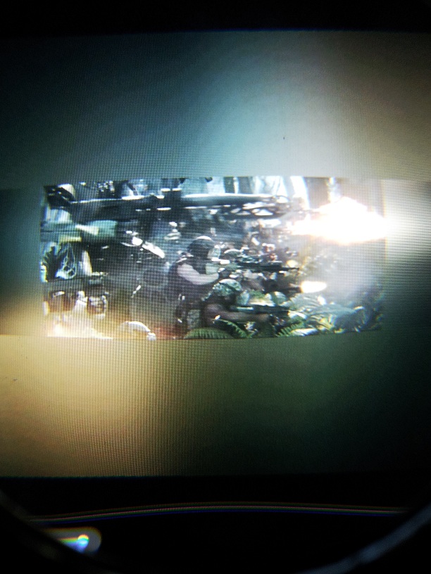

EDIT: This is a photo taken through one "eye" of an early Rift prototype, it should give you an idea.
http://www.svp-team.com/forum/misc.php?item=1971
Note - It looks very bad for several reasons: the image is not filling the LCD (aspect ratio problem) the lens is too far from the screen, the camera is not in the correct eye position, and there is very strong moire pattern, don't worry the pixels will not look that bad in the final rift.
DIY Rift.jpg, 143.4 kb, 612 x 816
Nick 3DvB
Thank you for picture. You already have prototype? hmm
I think it is not easy to implement. Tracking data from glasses must be handled and translated to x,y coordinates for video shift. It is the hardest thing because we can't use SVP or avisynth for this. You must have 3D-simulator with virtual screen wall in it. And this 3D-simulator must be fast to display all 60 fps from SVP on its virtual screen. In this case Borderlight will be fixed around screen and will not moving with heads moves. Otherwise Borderlight must be implemented inside 3D-simulator, not in SVP or avisynth.
You need to find source or samples of such 3D-simulator that must be video player's renderer at once. Do you know about something like this?
