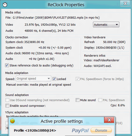

Hi, thanks for the replies. Maybe its how I have reclock setup thats causing the problem?
So its not tied to any type of video, its common to all. This is playing back a blu-ray, on 50hz screen with UseReClockToFixFPS=1. Screenshot shows reclock is still only receiving the original frame rate. SVP printout on image shows detected rate of 50.35. madVR and Reclock show it to be more like 50.00 so I don't know where 50.35 comes from. SVP doesn't seem to actually use 50.35 anyways, it keeps original frame rate.
http://imageshack.us/photo/my-images/196/50png.png/
With UseReClockToFixFPS=0 everything works perfectly again, 50.00fps output from SVP.
Here is output from additional information. Perhaps SVP assumes reclock is being used to change frame rate? In my case I only use it to get WASAPI out, nothing else.

I see. I reproduced your settings: 23,976 FullHD source, 50 Hz display, 6ch 24 bit Audio WASAPI.
I'd like to watch the movie this way: take a look and compare your ReClock properties and mine.
http://www.svp-team.com/forum/misc.php?item=1359 http://www.svp-team.com/forum/misc.php?item=1360

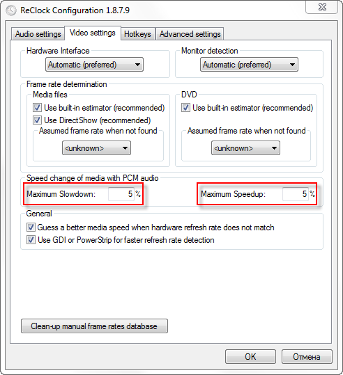

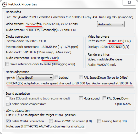

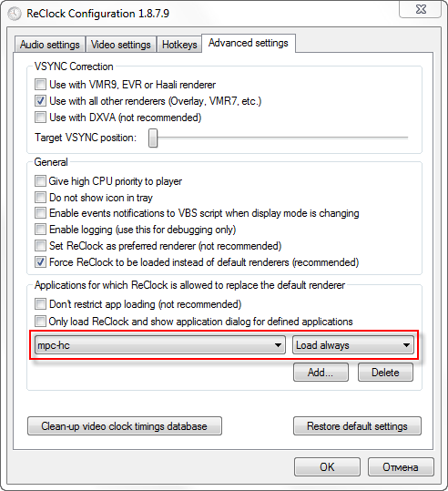

I can get it with some customized ReClock settings:
http://www.svp-team.com/forum/misc.php?item=1361 http://www.svp-team.com/forum/misc.php?item=1362

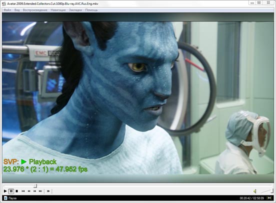

When I tuned up these settings I got real framerate indication in ReClock and 2:1 coefficient of framerate change in SVP.
http://www.svp-team.com/forum/misc.php?item=1363
You can try to repeat this settings or customize them as you want.

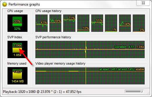

Double source frame rate gives to you maximum quality with minimum amount of artifacts.
In this case you will get 1.04x speed up by ReClock, that you can see at Performane graphs window of SVP.
http://www.svp-team.com/forum/misc.php?item=1364
