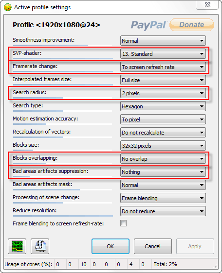

It is right values. But you can change some of it (marked with bold font) to get less artifacts. I reproduced your profile settings.
http://www.svp-team.com/forum/misc.php?item=1098
You can:
1. Change Search radius to 1 pixel. It makes dynamics of motion a little shorter and less waves-artifacts. It is easier to CPU.
2. Change Block overlapping to 0.25 of block. It makes motions in frame more coherence. It is heavier to CPU.
3. Change Bad areas artifacts suppression to Normal or Below Normal. It adds mask above artifacts areas but makes smoothness of such areas less noticeable. It is heavier to CPU.
4. Change SVP-shader to 2. Simple bidirectional. It will make new frames maximally sharp. Best choice for anime. It is easier to CPU or GPU if accelerated.
5. Change Framerate change to 1m or 2m. It will leave more source frames in video hence less noticeable artifacts on new frames. The equability of motion will be a little broken. It is easier to CPU or GPU if accelerated.
Good luck
SVP_profile_for_THX-UltraII.png, 17.39 kb, 456 x 562

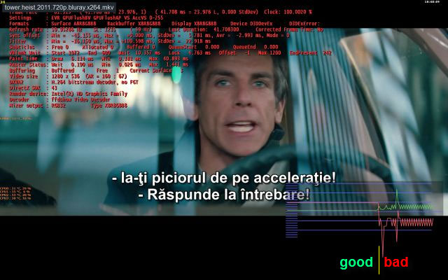

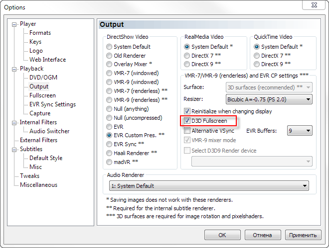

I like to check smootheness on EVR Custom Press Statistic by Ctrl-J in MPC-HC.
http://www.svp-team.com/forum/misc.php?item=1105
It smoothness and equability is OK you should to see a parallel horizontal lines on graphic.
http://www.svp-team.com/forum/misc.php?item=1106
EVR_Custom_settings.png, 20.44 kb, 660 x 499
EVR_statistic.jpg, 59.35 kb, 640 x 400

do you suggest EVR or EVR Custom?
Re: madVR and SVP
THX-UltraII
EVR Custom supports pixel shaders and subtitles rendering

gaunt: By blocks+Shader 11b (It is unreachable from SVP 3.0.6 GUI)
With the smoothness normal option, what are the differences between the selectable SVP-shaders Standard, Simple and Simple Bidirectional. And what are the artifacts of each of those three that can become visible?
SVP-shaders are our know-how. They are based and grown from MFlowFps (MBlockFps) and MFlow functions (see MVTools).
Simple and Simple Bidirectional have maximal sharp frames but less smoothness.
With the smoothness advanced option, what are the differences between the selectable SVP-shaders Original and Complex. And what are the artifacts of each of those three that can become visible?
I don't use advanced smoothness improvement now. But I can say that Complex shader is more complicated than Original. It can give more smoothness in simple scenes and more artifacts in difficult scenes.
About artifacts classification. It is difficult to me to explain it in English. I divide them into 5 categories:
- block artifacts (all SVP-shaders by block). It is like blocking artifact when decoding video with low bitrate.
- waved artifacts (all normal and advanced SVP-shaders). They are best noticeable at objects contours thus are called contour artifacts.
- structure artifacts. They appears on repeated similar objects in screen with wrong motion vectors detected.
- fading and flashes artifacts. It is related to wrong motion vectors detected too. Fixed in SVP 3.1. Coming soon.
- frame-margin artifacts. It is related to wrong motion vectors at the margins. Fixed in SVP 3.1. Coming soon.
- Halo artefacts and flicker (tremor) artifacts are the kinds of waved and block artifacts.
It is only First question and it takes much more than 15 minutes. wink
