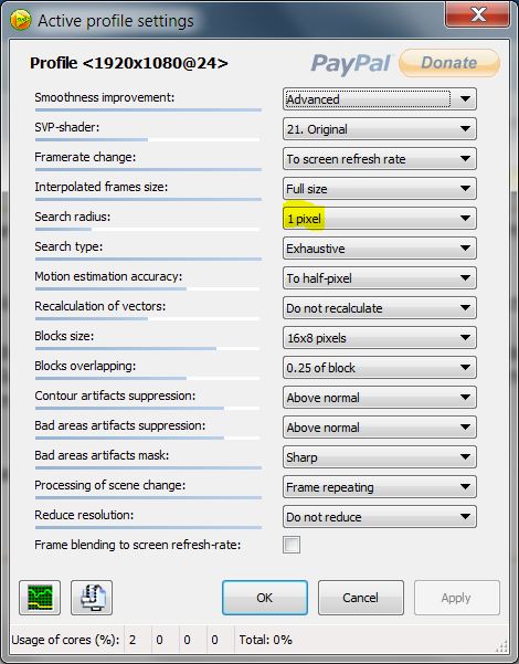

About the artifacts on window blinds. I had the same effect with window blinds and windows on buildings. I found that setting "Search Radius" to "1 pixel" solves this problem.
Here is a screenshot of my settings.
http://i.imgur.com/L0TTK.jpg

FDisk
It is but by limiting radius to 1 pixel you also limit the ability to find fast motion and motion in opposite directions.
In the next version there'll be adaptive search radius based on local contrast which solves the problem in most cases.

So, better set "Search Radius" to "2 pixels"?
Re: Bad Areas Algorithm?
FDisk
Larger radius - more motion can be founded.
