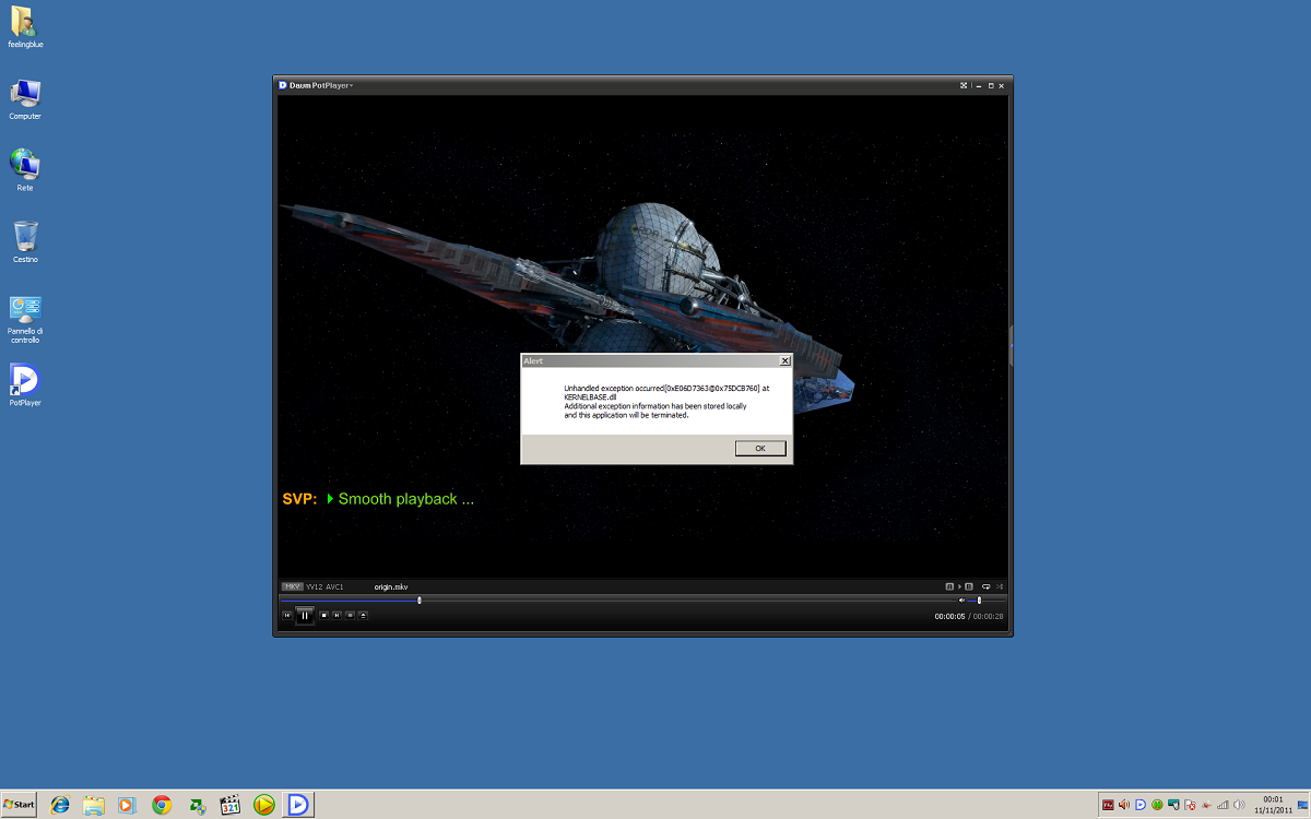

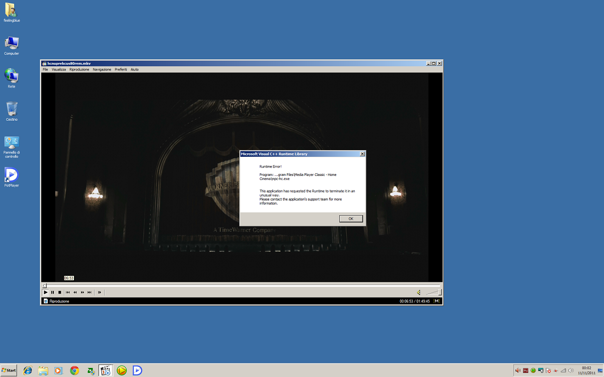

I followed exactly the procedures described by you but I have the errors in the attached files.

I have hear about this error with PotPlayer. The same error:
Unhandled exception occurred[0xE06D7363@0x74E0B9BC] at KERNELBASE.dll
Additional exception information has been stored locally and this application will be terminated.
has registered by user farookh1. (post in russian).
He resolved the problem by changing MKV splitter to *ffdShow (Haali Matroska).
About C++ error. Did you install VCRedist2008 from SVP 3.0.5 package?
Re: AMD Bulldozer and SVP
the VCRredist2008 is installed and up to date

in the mpchc i tried to use both splitters (internal or haali)

potplayer: everything works perfectly except "the motion estmation accuracy at quarter pixel" and/or "blocks overlapping at 0.50 of block" (these two settings generates always the kernelbase error)
mpchc: everything works perfectly except "the motion extimation accuracy at quarter pixel" (this setting generate always the runtime error)
in the "Performance graph" look at memory usage, I suppose memory usage close to 2GB limit (about 1.9-2.0Gb)
It's a danger value - it's very easy to exceed 2 GB memory limit especially with many cores CPU.

then i returned to my new PC and i disable the GPU acceleration ( the video card is the only important different element) and all works fine without errors
In real time if i activate GPU on SVP Manager the Potplayer immediately crash with famous kernelbase error (only if there are activated motion estimation accuracy or blocks overlapping)
now, with GPU on, potplayer crash also with shader23 and motion extimation at half pixel.

feelingblue wrote:
the memory usage is not the cause
I'm pretty sure you're wrong wink
Memory consumption depends on:
0. frame size
1. half / quarter pixel
2. number of calculation threads -> and in GPU mode this number is almost two times larger by default.
So 8-cores CPU + quarter pixel + FullHD frame size leads to too high memory usage in GPU mode.

I realize that I'm just a rookie sad
you are right
according to your reply i change "number of threads" from auto to 9 (same value of i7) and now all works fine
probably with "auto" the number of threads is too high and the sum of frame size, h/q pixel, number of c.t. brings the system out of memory
