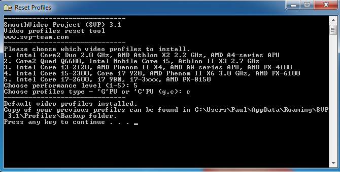

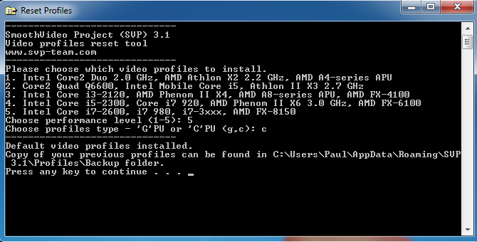

Greetings. I just installed SVP full package and SVP manager is not starting. I am using Win7 64 bit.
Edit: I got SVP manager to start by doing Start - All Programs - SVP3.1 - "Reset Profiles"
     - selected the option "5" of my CPU i7-3xxx (I have i7 3770k)
     - selected option "c" for CPU profile type (what is the difference between CPU profile type and GPU profile type anyway?)
     - Please see attached screenshot
After resetting the profile when I try to play the video with media player classic, I get the following error:
"MPC-HC terminated unexpectedly. To help us fix this problem, please send this file "...dmp" to our bug tracker"
svp-reset-profile.png, 40.46 kb, 670 x 340
Re: SVP Manger Not Starting Win7 64 bit - MPC-HC terminated unexpectedly.
I think it's some incompatibility with Intel's OpenCL SDK 2.0 you've installed (as I can see from the dump).
Anyway Intel's runtime isn't working correctly with SVP so you need to uncheck "GPU acceleration" option first.
Also check if SVPmark will work for you - it has an option to choose which video card to use.
