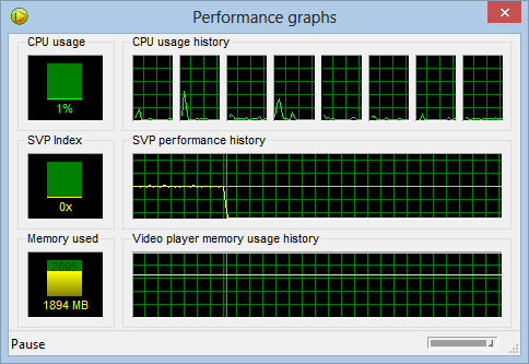

Hello, firstly I want to thank the dev team for making a wonderful project. I am on SVP 3.1.2 and experiencing "Warning: there's a memory leak in the video player". I have set ReloadAVSFactor=0; patched the mpc-hd.exe to use 4GB of RAM. But the message still pops up. There is also something I want to report, sometimes the player can register up to 2895MB (as in the screen shot); when it does that once, even if I close the MPC, SVP and then open them up again (without restarting Windows), the player can register 2895MB again; but if I restart Windows, it registers ~1871MB, and the warning message pops up again. I have attached the LastErrorLog and the screen shot when the player register 2895MB of memory.
It is not a bug. It is some magic of count this value. The value is not precise. You must be don't worried while player works without crashes with VC++ error.

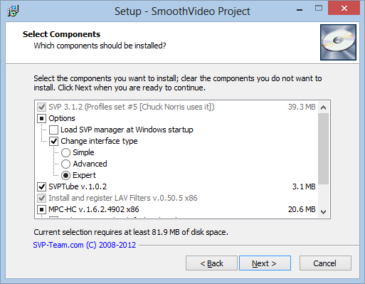

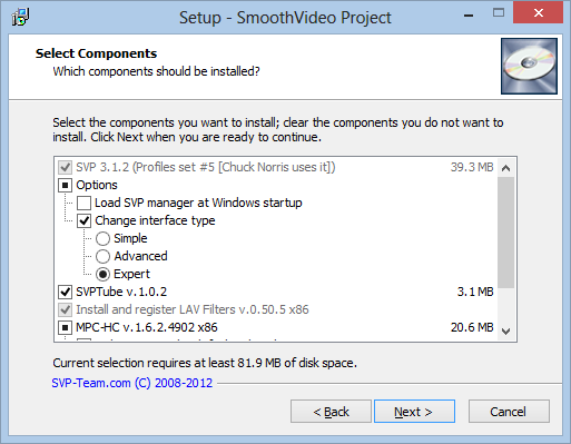

3. Re-install SVP 3.1.2, choose "Change Interface type-Expert" (I did not see "Option-Reset settings", screenshot attached).

Hero1711
Option reset settings is available when installed SVP is detected.
