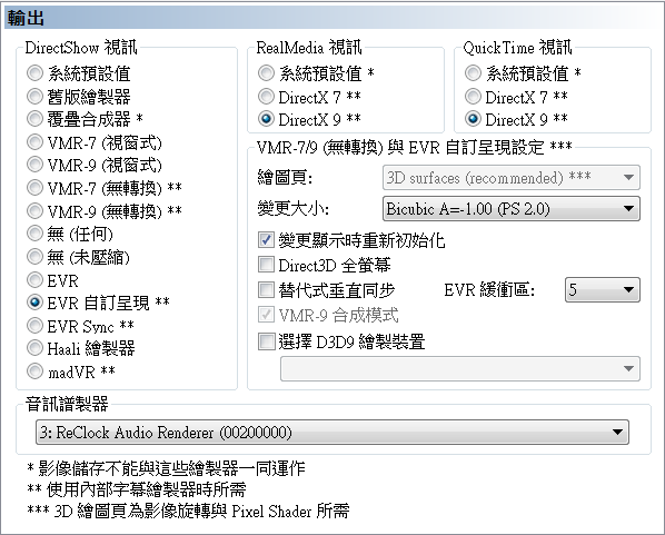

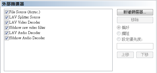

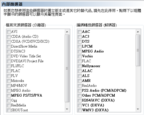

I'm using 2500K@4.5G with ATI 4850
All settings in 1080p profile are set to "default" except "Motion vectors precision" which is set to "Half pixel" due to low frame rate
CPU usage exceed 95% if all set to "default" sad
I would like to ask how can I improve the performance (maybe by software?)
And how's the performance if I buy a recent graphics card that support OpenCL
Thank you so much ! smile
external filter.png, 14.73 kb, 601 x 281
internal filter.png, 28.87 kb, 589 x 469
Output.png, 33.78 kb, 598 x 481
