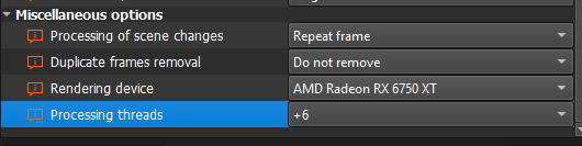

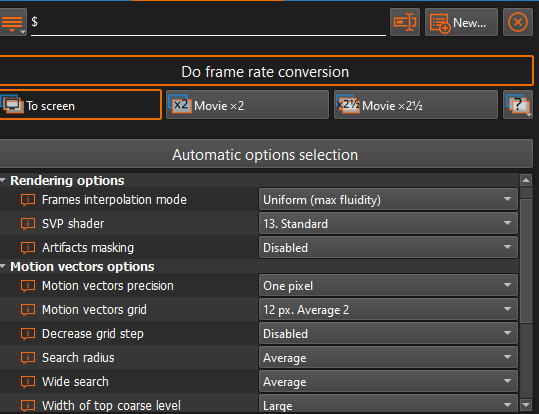

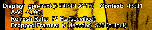

Hello everyone,
I'm experiencing a performance issue with the integrated mpv on SVP that hasn't occurred before. Recently, any increase in playback speed (even just 1.1x) causes the Dropped Frames counter to rise exponentially.
In the past, I was able to achieve speeds up to 1.8x without any frame drops on the same hardware.
I was testing some "mpv.conf" files to copy and paste and ended up not backing up what I was using. I don't know which command line is sorely missed, because as I said, I was able to interpolate and speed up the frames without any problem before.
I'm even interpolating to 72 frames per second; I saw that perfect multiples are ideal, is that correct? Unfortunately, even with it enabled, I can't perceive any difference in smoothness. I hope that when I buy a 240Hz monitor, this will change.
Screenshot_4.png, 25.38 kb, 539 x 414
Screenshot_5.png, 8.15 kb, 530 x 133
Screenshot_9.png, 107.05 kb, 484 x 96

if you have 72 Hz screen and do frame interpolation up to 72 fps, and then increase playback speed to 1.1x, then you definitely must have 7-8 frames per second dropped

Also the dropped frames rising counter doesn't always mean that you see actual issues on screen. Partially because, good displays are can hide such issues and partly because just opening the mpv overlay is a minor tax on the system which can cause mpv to drop packets if you are already at the limit.

Re: Exponential output dropped frames in mpv when speed > 1.0x (SVP active
you want something strange...
72 frames per second at 1.5 speed is 108 frames per second
your 72 Hz screen won't show 108 frames per second regardless of any command line options
it will only show 72 frames. because it's 72 hz big_smile

If you think it's caused by bad SVP settings, then go to your SVP profile -> Automatic options selection -> and select one of the default profiles to reset it to recommended settings, and restart SVP.

It's a more recent mpv version but not the latest, and it's not slower. Profile=fast will make some difference, but not enough to stop major packet loss. With this GPU, changing to hwdec=no will almost certainly perform worse than hwdec=auto.  I also wouldn't use those SVP settings as some of them could be causing problems for your CPU as well as your GPU. Better off using Automatic after SVP checks performance, then start to tweak from there.

I used to use RIFE to watch at 80fps on a 60fps display so what you are saying is possible, although that was on a 4080. SVP isn't the issue because no one else is suffering from this. Your SVP config could be an issue depending on your CPU which you haven't mentioned yet. Also you should post your mpv config on here. In the mean time, you can completely uninstall SVP, reboot then reinstall and retry with my previous Automatic profile suggestion.
and there're must be 20 dropped frames per second in this case, regardless of the player settings and even regardless of what the stats prints big_smile
I can imagine that with vsync off the player won't report any dropped frames
however the monitor will still update at 60 times per second
