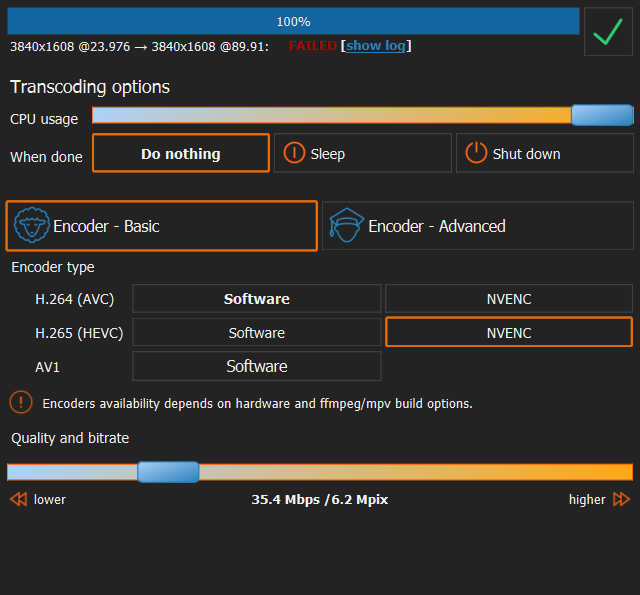

Hi. For a few days now I've been trying to transcode a movie I have on my computer from 24fps to 90fps using RIFE AI Engine. Until recently I haven't had any problem with transcoding but now after a few percent the process just fails.

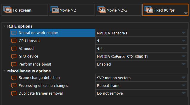

I've already tried to transcode other files, use all kinds of different settings in SVP and reinstall both RIFE AI and TensorRT, all to no avail. I'm attaching the log file that was generated during my last attempt as well as the settings I used. Also, during regular on-the-go interpolation there's no issue whatsoever.
As for technical information, I've tried using AI models 4.4, 4.6 and 4.9. For live interpolation I always use 4.4, because that's the best my GPU (RTX 3060 Ti) can handle at 1080p, interpolating to 72fps.
The file I was trying to transcode is an H.265 4K 24fps movie. The process starts as it should, goes on for a while and fails around 15-20% in. How can I fix this?

Thanks for the reply! I'm sure that I have more than enough space on my disk, so I suspected it may be the file. I tried reencoding the file again with Handbrake and for now it seems to have fixed my issue. I will update when the transcode in SVP finishes.
Re: RIFE AI Engine transcoding keeps failing
There indeed must have been a problem with the file that was exported by Topaz Video AI. Once I reencoded it with Handbrake everything worked.
