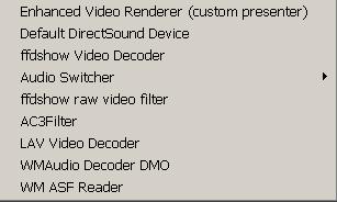

Take screenshot of DS-Filters while playing please.
MPC HC menu - Play - Filters
Like this:
http://i.imgur.com/SnCUE.png

Re: stop video tearing?
airport
Thank you. All is good there.

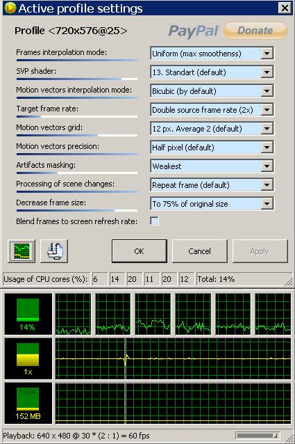

1. Maybe you can upload a little sample?
2. And show additional info from SVP menu please. There should be the answer.
lav video + ffdshow video + ffdshow raw ?  hmm

Ok I will try to upload something.
Do you want a segment that shows tearing or will anything do?
Is this the SVP menu you want?
svp.jpg, 72.55 kb, 425 x 638
airport
Oh! Yes. I didn't notice double ffdShow at the first screen (Thanks to Chainik). It is wrong. You need to leave one ffdShow.
Additional info is text-file from SVP menu - Information - Additional information.
Upload any fragment with tearing trouble. Source video without any transcoding.
Why you use decrease frame size to 75% of original size for 640x480 video?
airport
How do I "leave one ffdShow." ??
airport
MPC-HC menu > View > Options... > External Filters > select ffdshow, choose Block > OK
Please look carefully.
Is this ok now, tovarisch??
http://www3.telus.net/public/andnod/nfilt.jpg
airport
Is this ok now
fddShow os one. It is good, But I don't know about your tearing problem.

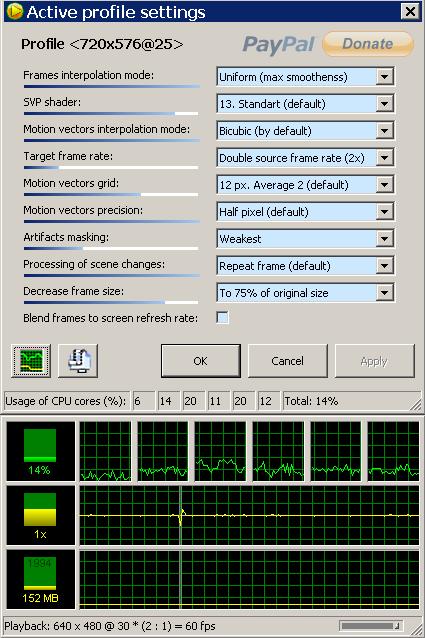

Here is some tearing.
Tearing happens as the Enterprise moves slowly across the screen.
See how NCC-1701-E is distorted.
The tearing bar shows it but when I print screen the tearing bar does not show it.
This screen shot has statistics, does that tell you anything?
http://www3.telus.net/public/andnod/ent.jpg
