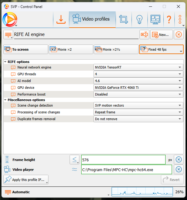

Hi guys!

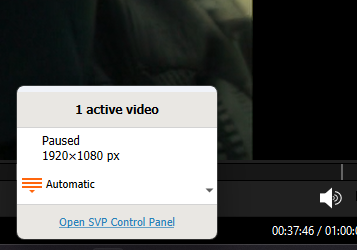

Im using Rife AI engine with MPC HC, it works perfectly, but i cant set it to use automatically.

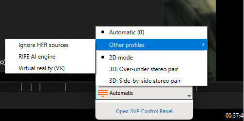

When i open a movie file, the active profile is "Automatic" and i have to change it manually to Rife AI engine profile.
Is there a way to make SVP select Rife AI engine profile automatically, everytime i open a movie file?
Screenshots added

Re: How to set SVP to use RIFE AI engine profile automatically?
do you see "frame height <= 576" on your screenshot?
any idea what this means? big_smile
Why the twist, instead of letting user select the profile they want?
