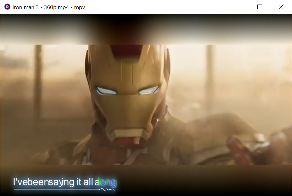

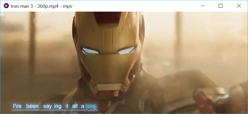

Thank you for subtiile file. I have checked this file with two video players.
mpv player.
mpv.png, 519.26 kb, 962 x 442
mpv_BarsUpDown.png, 853.58 kb, 962 x 646

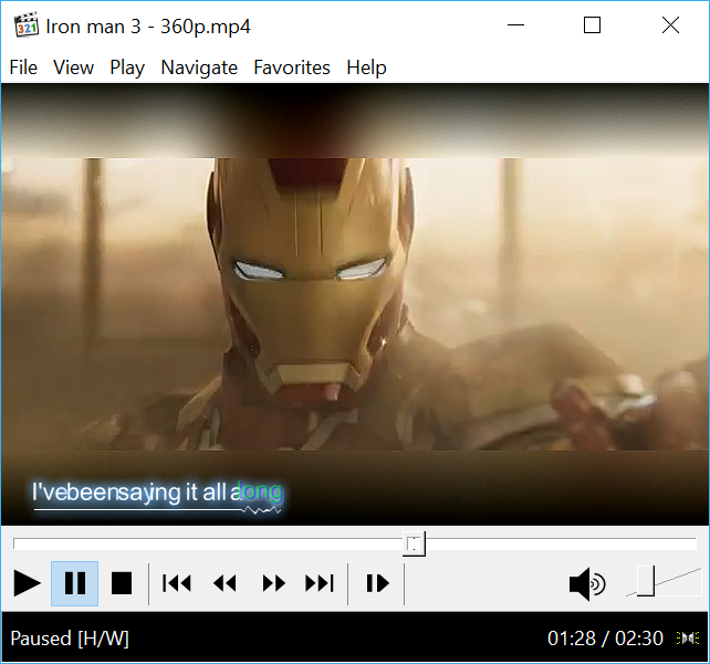

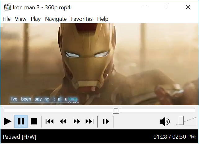

Re: is there any way to fix subs effect, when enabled outer light
MPC-HC
MPC-HC.png, 304.56 kb, 642 x 464
MPC-HC_BarsUpDown.png, 491.87 kb, 642 x 600
As you can see, subtitles work the same way in two video players.
Different image aspect ratio gives subtitles a different scale and spacing, but colored words overlay white words without shifting.
So, we have the problem: These subtitles do not work correctly in Emby Theater.
The solutions:
1. Use a different video player for such videos.
2. Change subtitles or renderer settings in the Emby Theater application.
3. Send a bug report to Emby Theater developers if the subtitles still do not work properly.

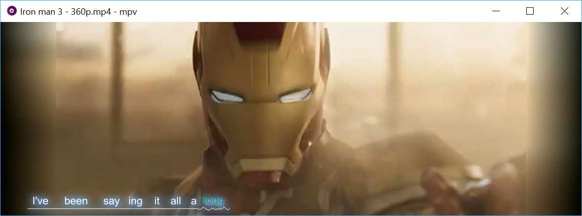

https://www.svp-team.com/forum/misc.php?action=pun_attachment&item=5755
You didn't tell me before about 20+ minutes position smile
I have taken position 1:28
because my test video is 2:30 wink
So, to check again, I have to start from the beginning
