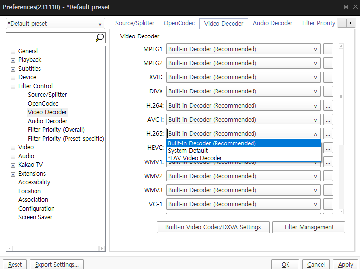

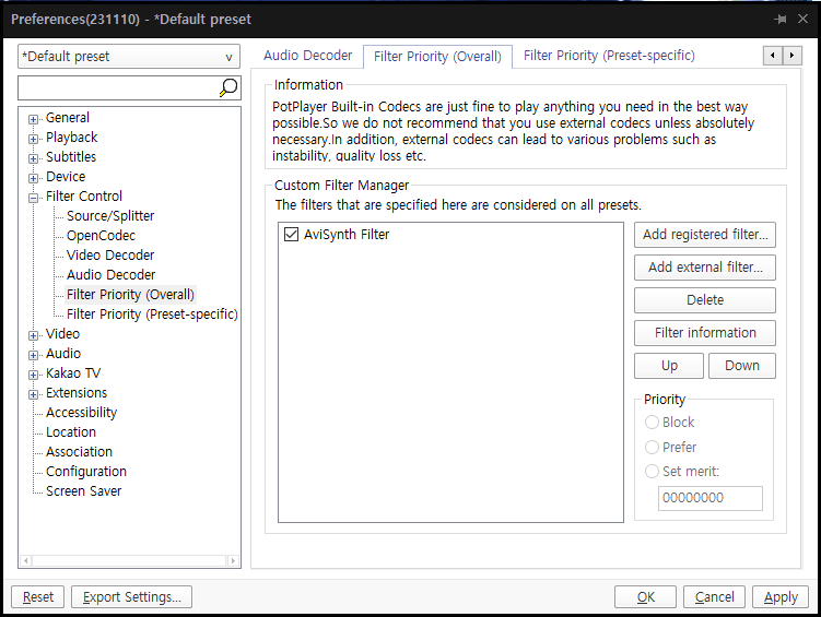

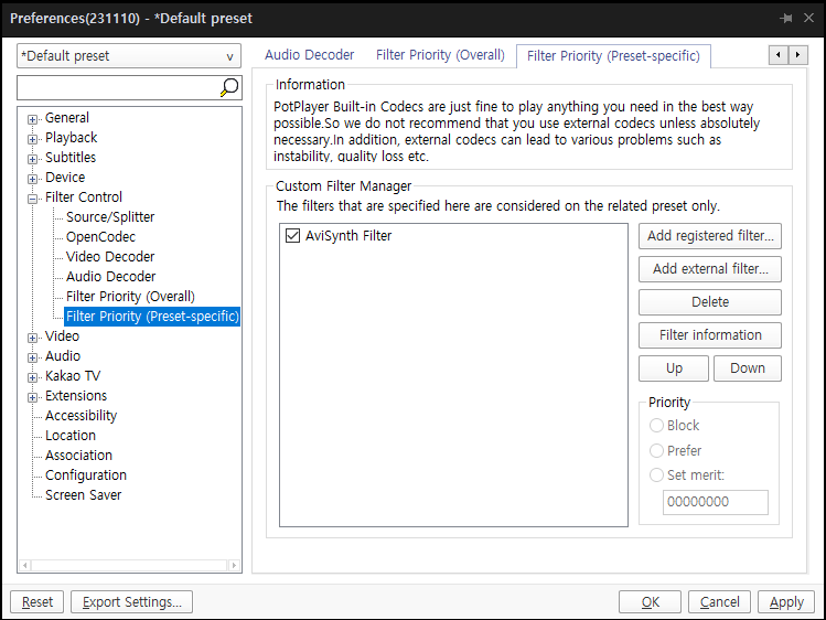

As shown in the picture, player's filter is set to 'AviSynth Filter'.
Nevertheless, if the AviSynth Filter continues to be ignored, should I set 'source splitter' and 'video Decoder' as 'LAV splitter' and 'LAV Decoder'?
(In Filter management - DirectShow Filter List, there is Avisynth Filter. but not pops up in splitter, Decoder collecting list.)
I'm sorry for not knowing how to set system settings correct.
Always thanks for help.

Re: Avisynth version misreading when using RIFE AI engine?
you have 'main.setup.potplayer.native' set to 'true' in SVP's settings
this option is 'false' by default
meaning you enabled it manually
WHY you did that?
