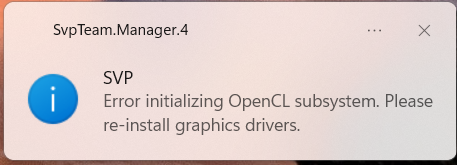

Hi ,I recently purchased SVP pro ,
my laptop specs are
cpu - i7 -10870H
gpu- RTX 3060 Laptop
Ram -32 Gb
OS - Windows 11
I tried SVP application ,by opening video file in mpv ,but I received a notification saying "Error initializing Opencl subsystem , please reinstall graphics drivers ,I tried reinstalling and tried to play video again ,but received the same notification
I also enabled the VLC extension and tried to play the video ,but there is no increase in frame rate and there is no GPU usage.
kindly help me to fix my issue

Re: Error initializing Opencl subsystem
It looks like corrupted OpenCL part of NVIDIA GPU drivers or some parts of OpenCL from another vendor.
Remove all GPU drivers from your system with utility Display Driver Uninstaller.
Then install NVIDIA GPU drivers from official site.
Thank you very much!!, the problem got fixed once I reinstalled my integrated graphics driver

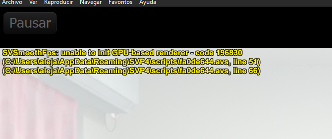

I have the same problem, I uninstalled the drivers with DDU and then I've installed the nvidia drivers but nothing was fixed.
I've attached the log.
Screenshot 2023-09-15 022805.png, 182.89 kb, 670 x 282
5 (edited by jandrop 16-09-2023 14:57:28)
After update windows, it was fixed.
Nice. Thank you for information. But!
In common case You don't need to update (or reinstall) Windows.
Just to uninstall all GPU drivers from all vendors and install NVIDIA drivers again.
