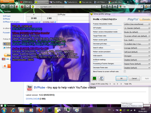

Re: You can create profiles according bitrate?
With SVP lav filters will not start.
Tested Windows 7 and XP.
Nvidia drivers 276.
OpenCL symptom, Motion Vectors Interpolation Mode is set to change Biliniar and leaves.
Lav cuvid decoder tested.
It will be a bug?
You will have a solution?
I leave an image.
SVP whit LAV.png, 237.45 kb, 500 x 375

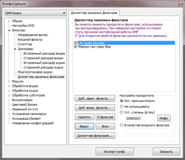

lamerced
You need to tuning your KMPlayer to load ffdShow raw filter after LAV filter in the chain.
Autotuning is available to MPC-HC (from the SVP Full Bundle) only. All another players you need to tune yourself.

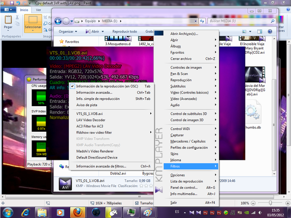

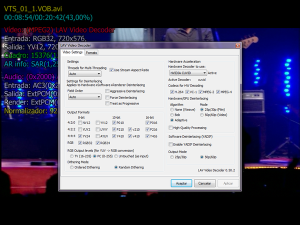

OK,thanks MAG79 and Chainik.
I think I have solved more or less.
Problems with KMPlayer and codecs Lav.
The solution is where you remarked.
Images:
Excellent, excellent work and grand stand, totally perfect.
Thank you very much new actulizaciones end waiting to be surprised even more.
Perfect.
KMPlayer settings.png, 285.31 kb, 600 x 450
LAV settings.png, 232.24 kb, 600 x 450

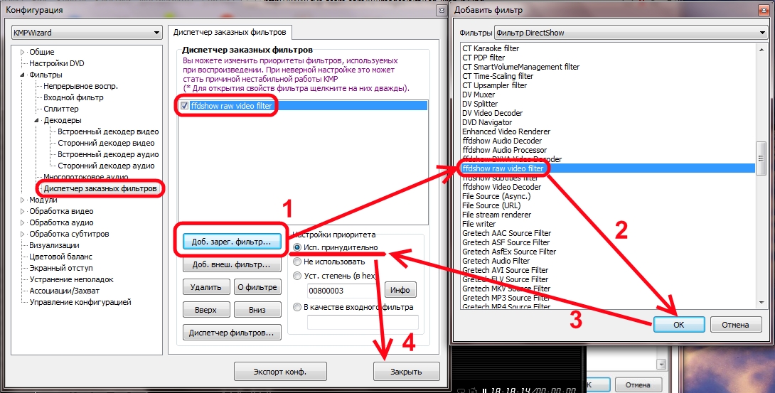

lamerced
Pictures with Russian symbols but lines and arrows are unilanguage  big_smile
http://www.svp-team.com/forum/misc.php?item=1580
1. Register LAV filters, dont add it as file, add it as Direct Show Filter
2. On the figure I show how you can add FFDShow Raw Video, but LAV Video Decoder add first just as FFD RAW. Note that LAV Video Decoder must be higher in the list than FFDRAW
http://www.svp-team.com/forum/misc.php?item=1581
KMP FFD LAV.jpg, 72.39 kb, 636 x 551
