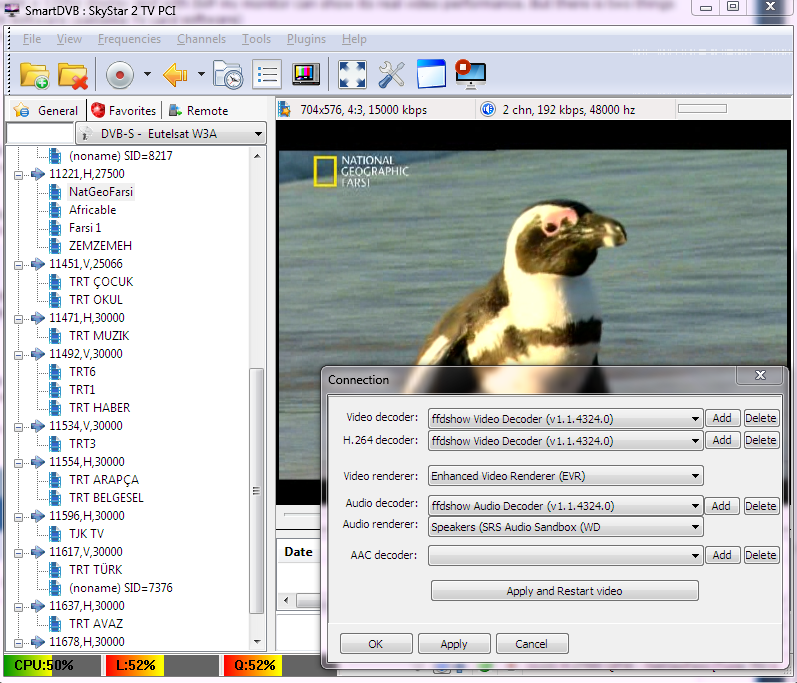

smartdvb is also work nice with svp and is freeware. http://www.smartdvb.net
the only trick is  that you must run svp manager as Administrator because smartdvb work in elevated permissions.
enable mpeg2 and h.264/AVC  decoding in ffdshow and if you need try enable deinterlacing in svp.
