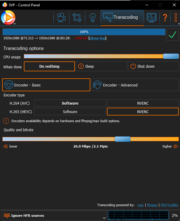

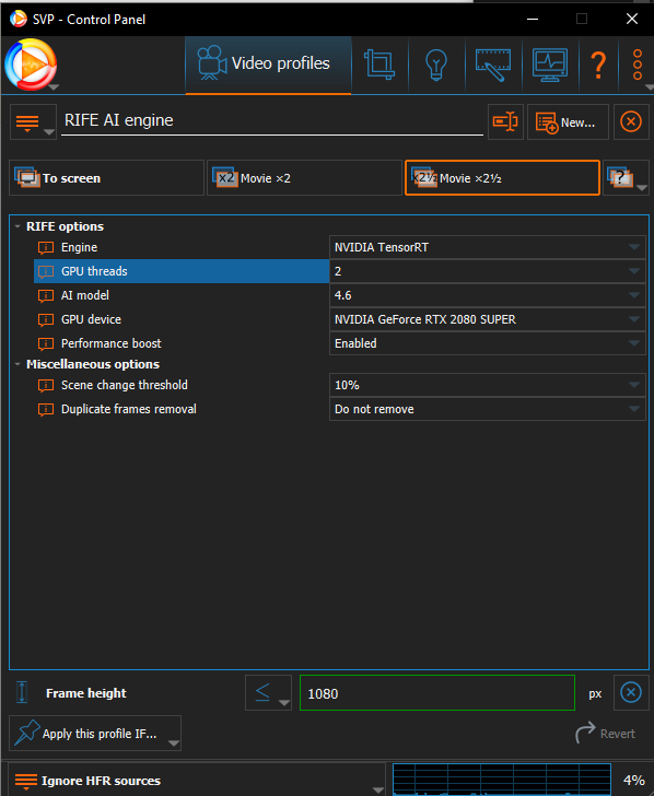

Hi, I'm getting an error while trying to transcode a file with the RIFE AI profile. I'll leave every info I can think of here hoping that someone can help me.
- In the attachments you can find the log that comes up when you click "show log" on the transcoding tab of svp4. It shows the error but I don't know what it means/how to fix it
- RIFE profile settings: attachment called RIFE_AI_Engine_Profile.png
- Transcoding settings: attachment called RIFE_AI_Transcoding.png
RIFE_AI_Engine_Profile.png, 37.25 kb, 598 x 728
RIFE_AI_Transcoding.png, 40.78 kb, 596 x 731
