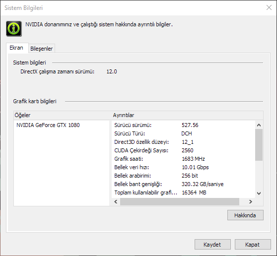

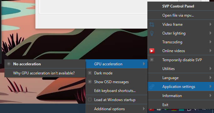

I am using GTX 1080, earlier versions of SVP was recognizing my gpu but i noticed its not anymore.
Does something changed?
Thanks.
Driver.png, 24.78 kb, 558 x 516
No GPU.png, 129.88 kb, 684 x 360

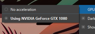

It shows GPU.
Yes GPU.png, 143.46 kb, 308 x 110
