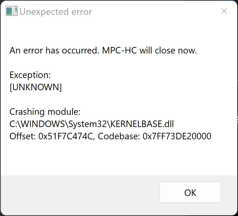

Hey,
I noticed earlier this week SVP wasn't detecting playback in MPC-HC, so I reinstalled MPC-HC, AviSynth, madVR, core for directshow 64bit, and LAV Filters (do those last two matter in my environment?) Now, AviSynth won't load at all -- double clicking it in the 'external filters' tab crashes MPC-HC, and opening a file produces an error message  (attached pic)
I've reinstalled everything a second time, and I've tried reinstalling everything through their own websites to no avail. I've also tried rolling back my Windows version (currently on build 10.0.220000) and nVIDIA driver (currently on 3.25.1.27) to no avail. I have a 3080 Ti, if that matters. Open to all suggestions!
Update: still not able to fix it, but I tried changing my color space to no avail, and I figured out how to output an AviSynthFilter log:
T   8628 @           0: Filter version: 1.4.3 # svp
T   8628 @          53: Configured script file:
T   8628 @          67: Configured input format  NV12: 1
T   8628 @          82: Configured input format  YV12: 1
T   8628 @          92: Configured input format  I420: 1
T   8628 @         101: Configured input format  IYUV: 1
T   8628 @         111: Configured input format  P010: 1
T   8628 @         121: Configured input format  P016: 1
T   8628 @         131: Configured input format  YUY2: 1
T   8628 @         140: Configured input format  P210: 1
T   8628 @         149: Configured input format  P216: 1
T   8628 @         159: Configured input format  YV24: 0
T   8628 @         168: Configured input format  Y410: 0
T   8628 @         527: Configured input format  Y416: 0
T   8628 @         535: Configured input format RGB24: 0
T   8628 @         540: Configured input format RGB32: 0
T   8628 @         544: Loading process: mpc-hc64.exe
T   8628 @         549: Active CPU feature: AVX2
T   8628 @         554: FrameServerCommon()

Re: Immediate Crash with AviSynth Filter
this means it can't find or load avisynth itself (avisynth.dll)
install it manually: https://github.com/AviSynth/AviSynthPlu … 220317.exe
