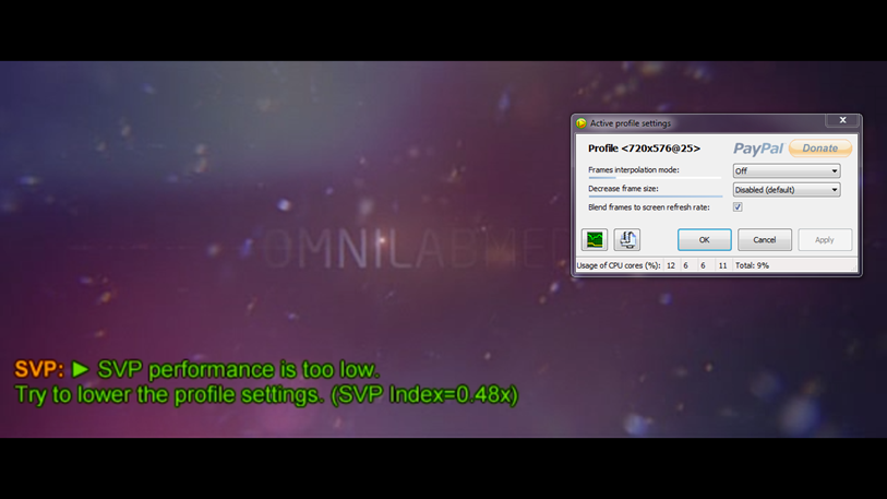

Hi, i got this massage although interpolation is off?
(Only Frame blending is on)
Do you know why?
Config:
Win7 x64 Q6600@3.600Mhz
SVP  3.1.1
LAV Filter 0.51
Running it with Mediaportal
All .avi (xvid) movies. No Problems with h264
I can watch the movies without problems, when i disable the osd message.
Bild1.png, 297.61 kb, 813 x 457
Re: Message:"SVP Performance to low", but interpolation is off?
MaxMan23
It is not normal.
1. What CPU Usage shows task manager?
2. What process use CPU intensively (see in task manager)?
3 (edited by MaxMan23 07-04-2012 10:44:36)
Look at the picture. The CPU is not so high. It is a fresh Win x64 on a SSD. Mem usage is 1.35 GB of 4 GB. It is not so high.
I got the same message an a Vista partition on the same PC.
Is it only a wrong message (of SVP)?
MaxMan23
Oh! Sorry. I see now.
I don't know why, but you have slow frame speed, about 0.48x of normal speed.
Do you manualy decrease play speed in player?
23.975 * (1 : 1) = 23.975 fps -(CF)-> 50.008 fps
Wow!
Why you do so?

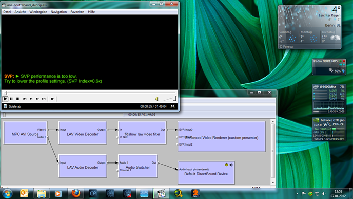

7 (edited by MaxMan23 07-04-2012 10:57:32)
The same im mpc hc
Bild2.png, 333.35 kb, 688 x 387
MaxMan23
I see another SVP-index. It is 0.6x here.
Can you show me AVS-script?
MaxMan23
Thank you. I confirm the bug.
It is wrong OSD-message because of wrong SVP-index calculation when use "Blend frames to screen refresh rate" setting.
We will fix it.
Now you can simply turn off OSD (as you did) and watch your movie without any problems. wink
