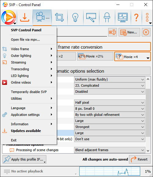

I have received your problem report. I don't see any errors.
Try to open video with SVP menu: Open file via mpv...

That's exactly what I did
Same with AVSF in other player

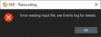

Oh, I got this error when try to transcode
Screenshot 2022-04-12 061059.png, 6.74 kb, 344 x 125

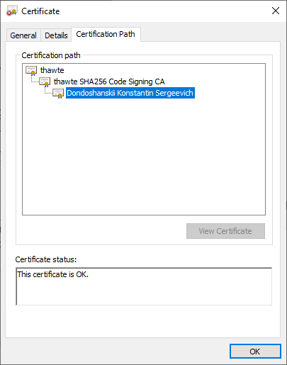

right click SVPManager.exe - properties - Digital signatures - details - view certificate
do you see any errors there?
from your logs I can see that the system gives "The time stamp signature or certificate could not be verified or is malformed" error
no idea why hmm the .exe is timestamped properly
most likely the problem is in root certificates
check the "certification path" page
Re: No playback detected even with built-in mpv
Nope, there's no errors
Screenshot 2022-04-12 173455.png, 12.12 kb, 405 x 515

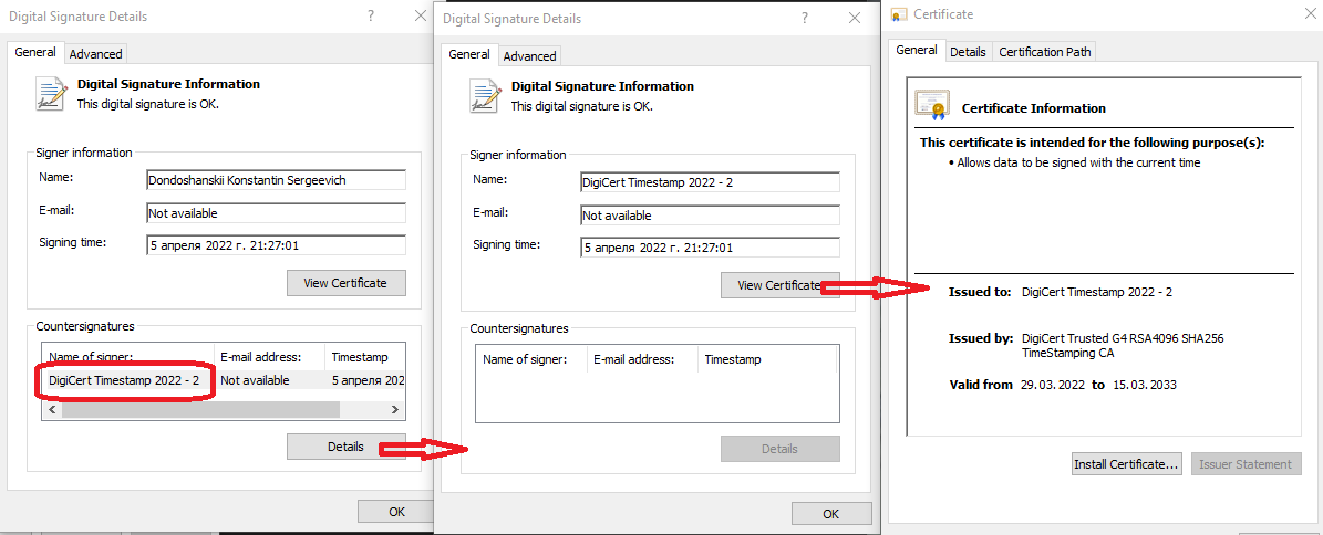

the error tells about timestamp signature, not the main one
may be the problem is there, cause DigiCert cert is a new different one, even with the new root (DigiCert Trusted Root G4)
https://www.svp-team.com/forum/misc.php?action=pun_attachment&item=5379&download=0

Thank you, the problem is done
I just need to manual download the certificates (because my PC doesn't have that certificates) from DigiCert
