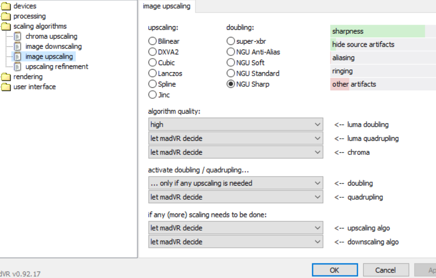

I use default madvr settings.
But I don't think it's related to madvr because it still uses 100% gpu after exiting madvr.
madvr settings.png, 92.7 kb, 863 x 551

you can't "exit madvr", you can only change video renderer to something else (e.g. EVR) in the video player settings
and I really doubt "NGU sharp" is the default value
Re: MPC-HC uses 100% of my GPU
I just uninstalled and reinstalled it now, so i think these are default settings.
Btw, i tested some other algorithms but they still put a lot of load. Maybe i shouldn't watch a 1080p movie on my 1440p screen at 144fps smile
But idk, I also tested without svp, and it seems all algorythms used to match my 1440p screen are heavy on my gpu (and it's not a bad one)
In the end, I also tested mpc-hc + svp and without madvr : no more 100% gpu. I guess i'm fine this way.
unless you cleared the registry manually - nothing changed after madVR "reinstallation"
default upscaling option is "Lanczos" + "Cubic" in chroma upscaling
