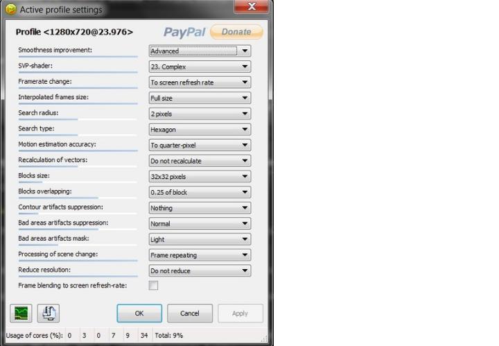

Also, i have had neutralized the artifacts combine with the best smoothness i can have ( i will post a picture of my setup) but with the new version and with less settings i can't achieve the same (artifact masking with no stuttering).

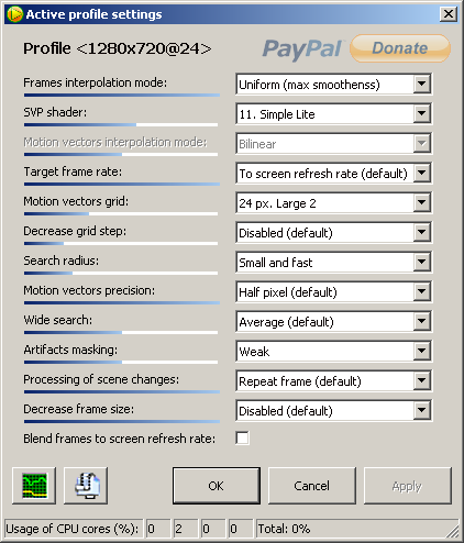

These are my current settings (3.06) with no stutter. Is it possible to achive equal settings with 3.1.1?
http://oi41.tinypic.com/1id89f.jpg

Equal settings:
http://www.svp-team.com/forum/misc.php?item=1398
SVP_3.1.1_profile_settings.PNG, 27.17 kb, 422 x 494

Yes the stuttering is better with your settings, but the artifacts are very annoying something i didn't have in 3.06.
For example in the 3rd Transformers from scene 1.52.00 to 1.54 something the artifacts in the buildings looking so crazyyyy with 3.1.1, but with 3.06 are minor, even my wife can't see them wink

After 2 hours of searching and reading i have found the best results for me with these settings that are almost identical in performance and smoothness with 3.06:
http://oi41.tinypic.com/16lahxy.jpg
Now I can watch all my favorites movies without the annoying artifacts!!!
