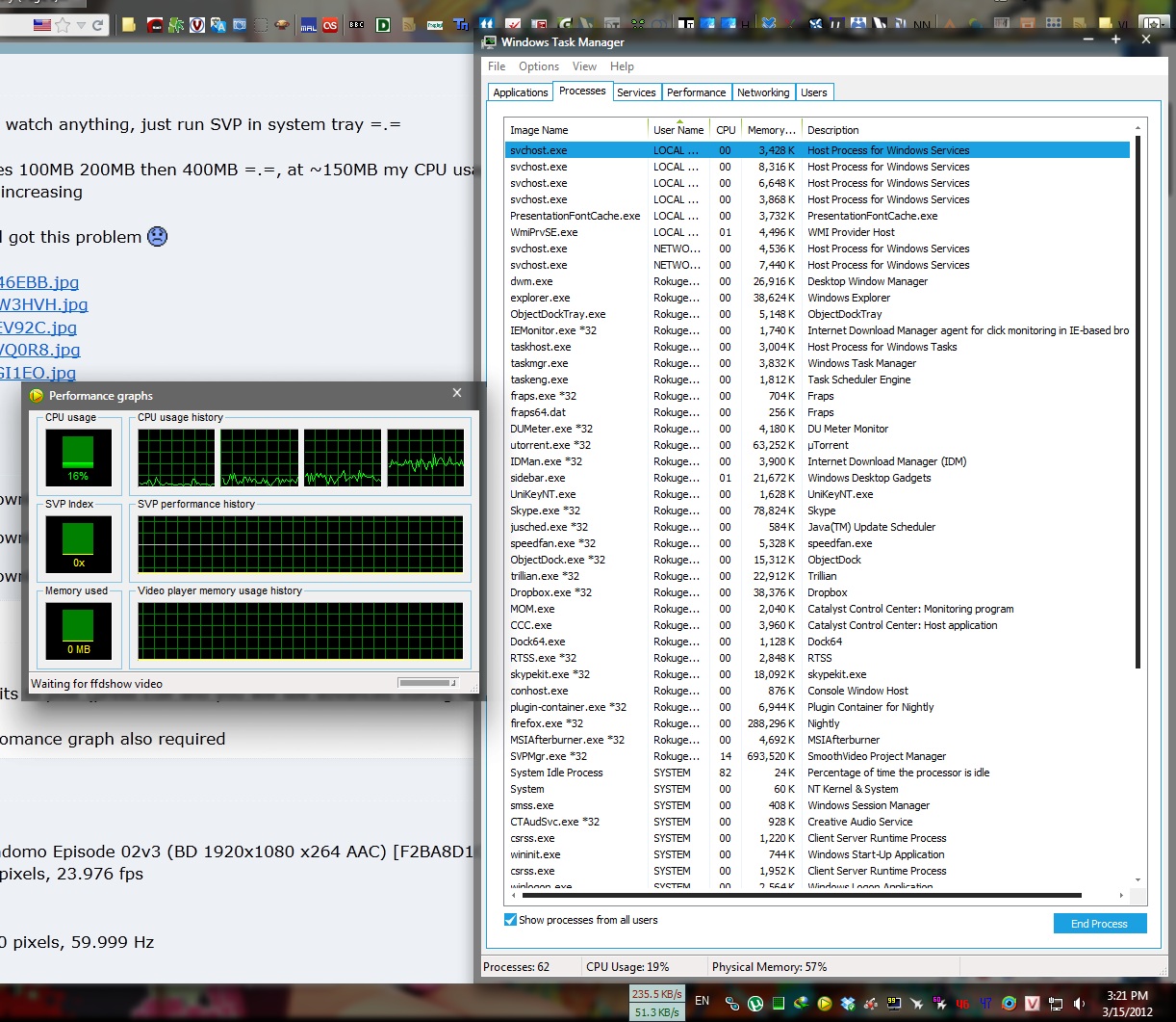

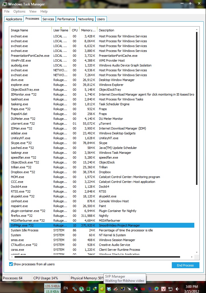

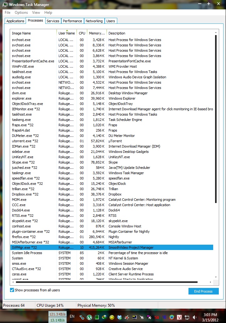

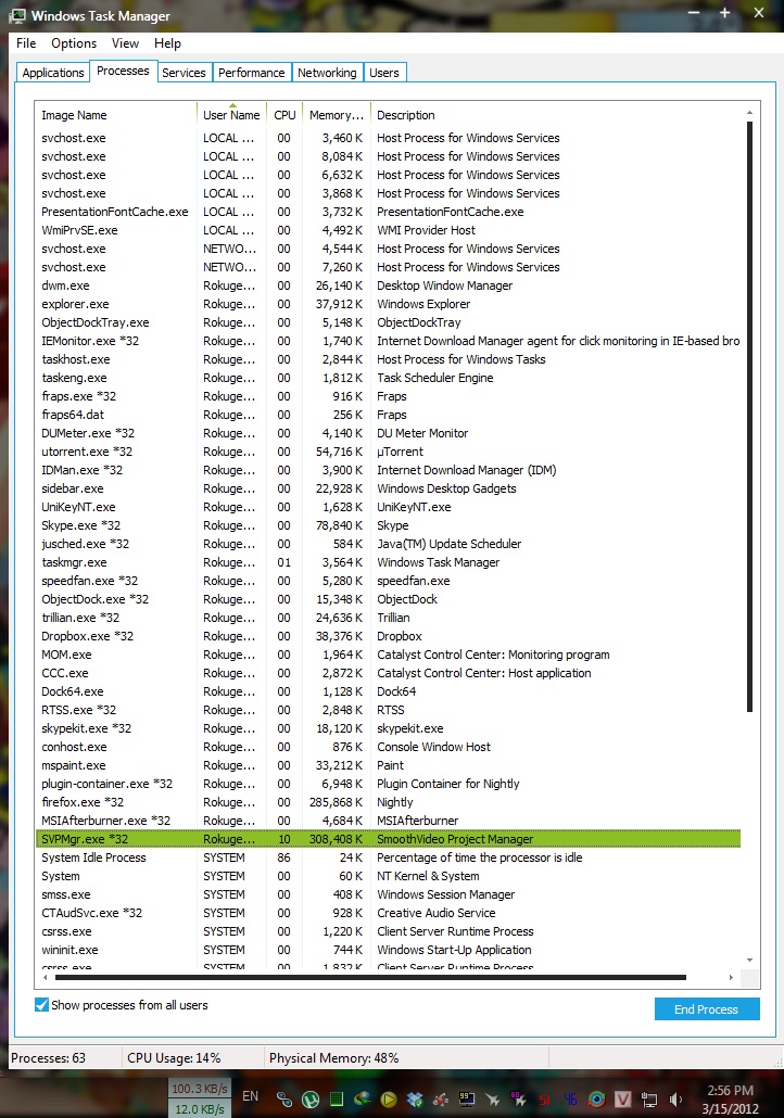

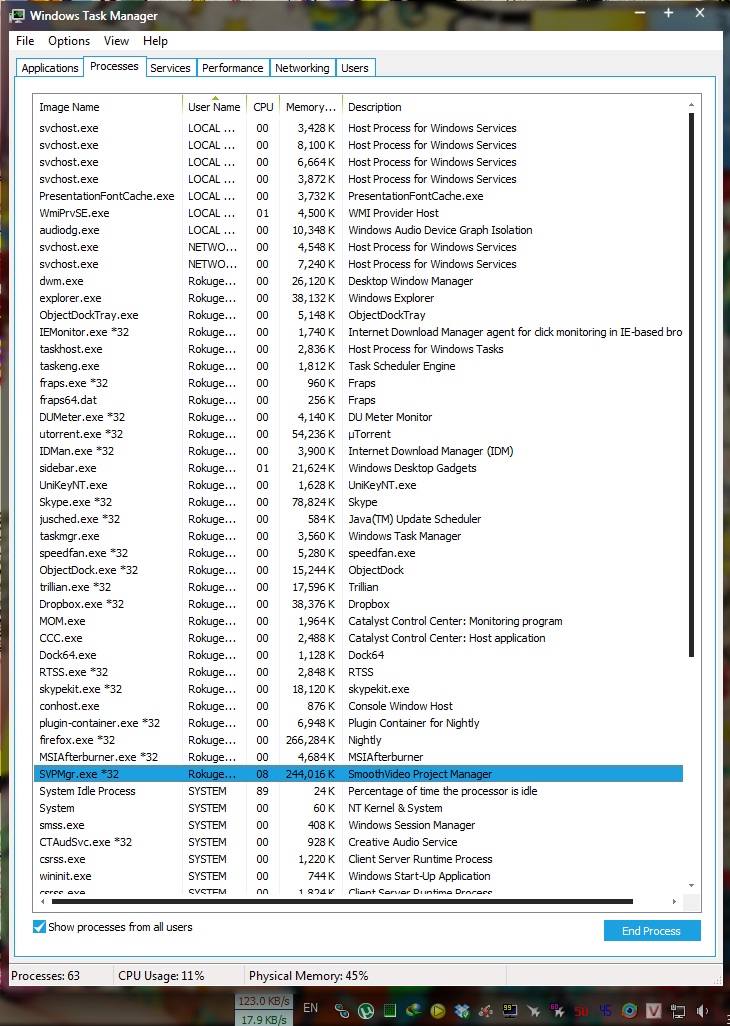

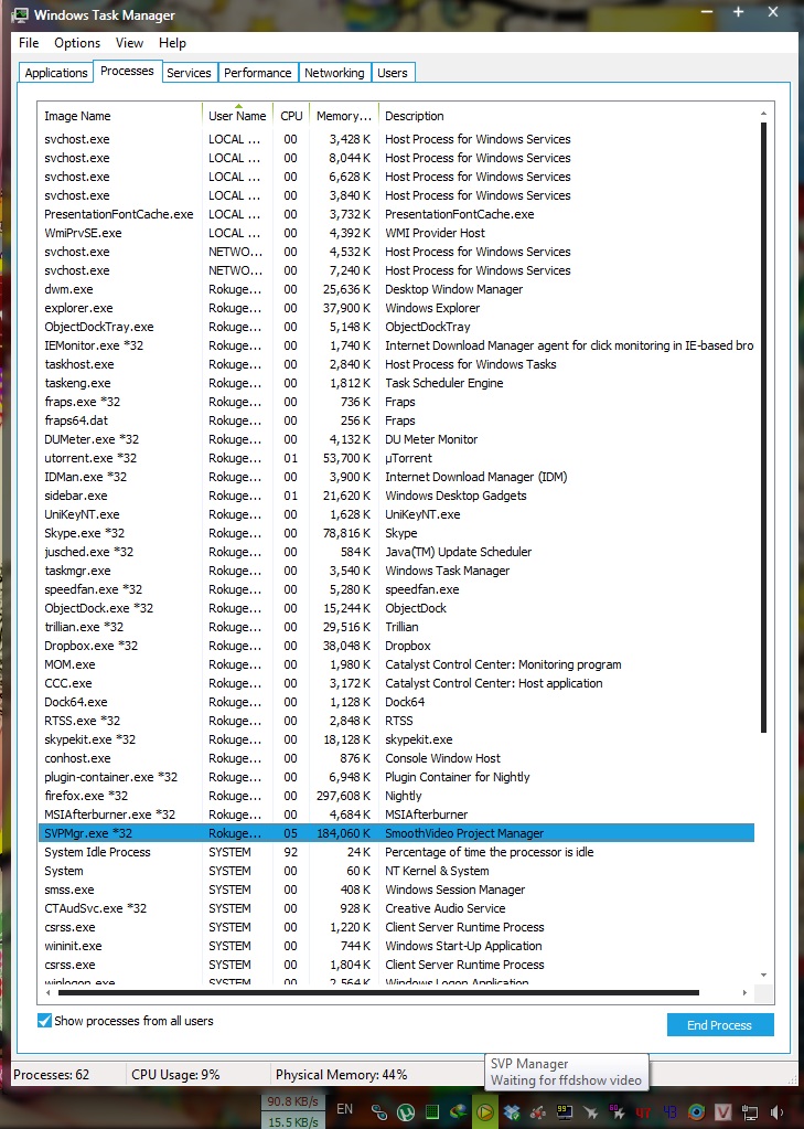

SVP 3.1 ate a lot of my RAM but I didn't watch anything, just run SVP in system tray =.=
at first it only uses ~15MB then increases 100MB 200MB then 400MB =.=, at ~150MB my CPU usage for it increase too ~10%
but when I play video the memory stop increasing
I uninstalled and reinstalled SVP but still got this problem sad
http://sadpanda.us/images/875509-EQ46EBB.jpg
http://sadpanda.us/images/875510-ANW3HVH.jpg
http://sadpanda.us/images/875511-78EV92C.jpg
http://sadpanda.us/images/875512-KEVQ0R8.jpg
http://sadpanda.us/images/875514-T6GI1EO.jpg
http://sadpanda.us/images/875530-LX2AX2W.jpg
sad
Re: [FIXED] SVP 3.1 eats a lot of memory
aloola
pictures are not availibal, please attach its to post (press Edit and you will see advanced editing form)
and avs-script + add.information + perfomance graph also required

Unpack and replace SVPMgr.exe in SVP 3.1 folder
It is quick fix for avoid the problem but not Final fix. wink
Now used memory is stable when SVP is not active (waiting for ffdShow, on pause) or on playing.
But memory leaks are still able when using SVP-interface.
