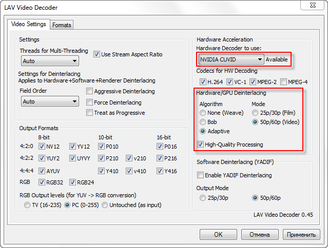

MAG79 could tell how to use true hardware deinterlace on NV cards with SVP. The short answer is "LAV CUVID" wink

He is right. The best deintarlace is hardware deinterlace. I use LAV CUVID with Adaptive hardware deinterlacing algorynthm.
http://www.svp-team.com/forum/misc.php?item=1292
Did you try to watch you deinterlaced video at 50 Hz monitor mode without SVP?

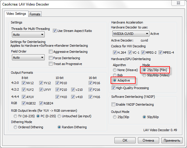

Thank you. I just watched at your sample. It is progressive video without interlace wink It is 2:2 pulldown (telecine) with wrong field shift. You can look at the video frame-by-frame. In 50 frames each second is double. I recommend to use for this video such settings of LAV:
http://www.svp-team.com/forum/misc.php?item=1305
Then you will get original frames without doubles.
