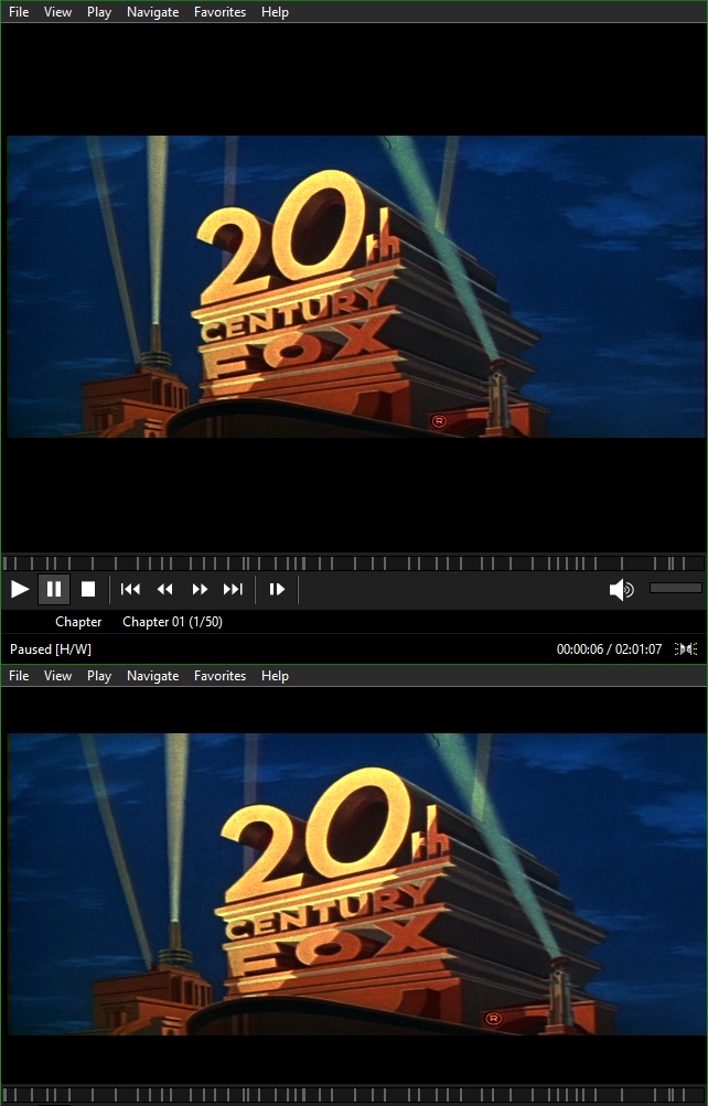

I have a trilogy of movies that are filmed in 2.40:1 aspect ratio but contained in standard DVD 4:3 aspect ratio. On playback in a standard DVD player, there are black borders on all four sides.
SVP is great at manipulating it so that I can get rid of the two side black borders upon playback. That is not enough though. I want to be able to transcode it into 16:9 aspect ratio, so that I have a copy that works on everything I might play it on.

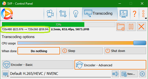

I've tried setting a number of the frame size options, but the end result is always stretched in some extreme way.
In the attached screen shot, you can see that it's setting the resolution correctly, but when it completes, the log shows that it was ran with 'format=dar=1.33333' as one of the commands. That is the display aspect ratio for 4:3.

When you are using SVPcode you have chance to use extra options for used libavcodec (ovcopts).
You need to use Encoder-Advanced mode (as shown at your screenshot).

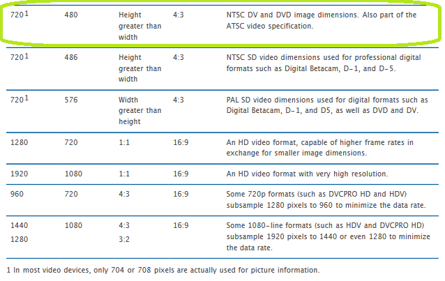

So in your case you have 720x480 movie with 16:9 picture aspect ratio.
In internet I found formula for NTSC DVD: (16 * 480) / (9 * 720) = 7680 / 6480 = 32 / 27
