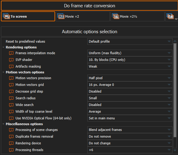

i use SVP with x64 Mpc-HC and MadVR, my madVR settings are not particularly high since i found the AI up scaling like NGU makes my Graphics card whine like a Tesla coil, i can add them if they are relevant.
Current settings are below
Found them randomly on a post somewhere and i thought they worked well in both anime and film with little amount of artifacts.
My cpu usage is about 15-25% at 120 fps and my gpu is anywhere from 40-60% depending on madvr this is usually 1080p upscaled to 1440p with these settings.(I usually don't watch content above 1080p because of file sizes, so 4k settings are not really relevant for me)
I wanted to find out if there is anything i can do to get better quality when i have this much performance overhead. Any suggestions?

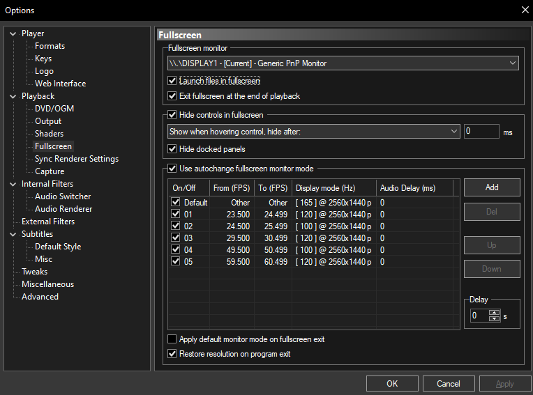

The first thing i looked at was using exact multiples of source and then some sorta wonky stuff with my refresh rate from this post:
https://www.svp-team.com/forum/viewtopic.php?id=3549
And i want to make sure i've got the settings right, they are below
Because i'm really not sure how i should handle the different frame rates when my display is capable of 165 fps.
